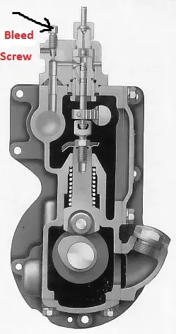

I would say you need to open the bleeder valves on each pump. In 40 years of dealing with D 318 big brother to your D 315 engine ,TWICE on needing to prime I wasted hour bleeding with just line nuts loose. I have no idea of why, but on the one occasion I pressurized the fuel tank with air, had fuel flowing out the lines and not a pop for hours. This was a farm tractor being used every day. Fuel pressure fell at the end of the day and fuel tank very low. So started the next day with filters in hand. Not an unusual event to have low fuel be the last event of filter clogging. Not that it happened often ether.
Unfortunately I believe the newer diesel formulations are also part the trouble. We have been fighting Kubota MU 7040 ( mid 90's model, about 3500 hours). I have been the operator care taker since 2000. I honestly don't remember changing fuel filters in it the last time. Used in a 14 acre vineyard. Almost always left with full fuel tank. Years ago a crew ran it out of fuel. Then it has mostly sat since spring of 2020 when vines were removed. I rented it for 5 to 20 hours per year until 24 when I bought it. Spring of 25 it did not start had to prime it. Used less than 30 hours for the year. Used this spring discing around the yard. Then my son started it, before moving it died. It has plastic fuel bowl and could see water. Changed the filters, never getting it to prime. Son took it upon himself to have full time mechanic friend come help him prime. He concluded injector pump was gummed up and sent pump off. I am waiting to know how this ends. I am hoping the pump shop doesn't decide to hose me. I would of consulted another mechanic who has done pump work for me before.
Depending on your wishes danda get cheap 1/4 drive socket and smash until it is tight on the oval bleeder valve or just buy one from Cat. And if you think low flow to transfer pump is part of the problem have helper use a rubber tipped blow gun on vent in fuel cap. Or if no helper get rubber cap that fits fuel filler hole from hardware store, then install a tubeless tire valve stem in cap, then an airline pressure regulator and setup to about 5 psi on fuel tank. Much more could damage the tank.

Posts: 4,237
Thank you received: 92
this is the bleed screw being mentioned above. A socket used to fit the top of shock absorbers will fit the two flats bleed screw.
The engine should start and run with only fuel tank gravity feed head--it will be low on power if put to the test but it will run.
Hope this helps.
