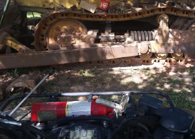

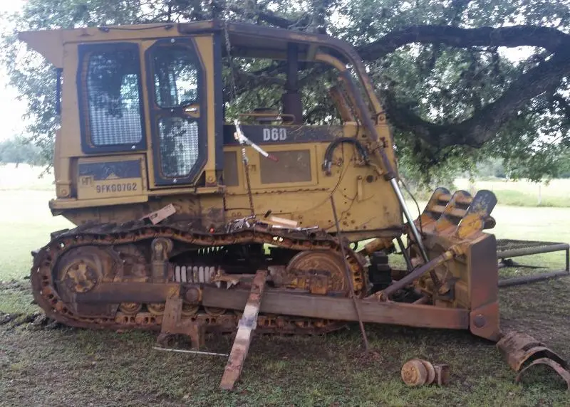

I guess it is time to look for a donor machine. We are putting enough of the tractor back together to be able to move it to a repair shop. I loaned a friend the use of a shade tree for what supposed to be a fairly easy repair which quickly went way south. :ohwell: see the pics.

8 years 3 months ago #149128 by Old Magnet
That's a 1996 machine built in Brazil and at the end of s/n production, 155 hp. Replaced by E & G models of the same era. Might be a little tough to come up with salvage unit.
Just goes to show anything can be tore up !!!!!!

Photo 1: I start to pull the equalizer bar into place with the winch on my ol’ grizz.

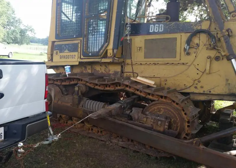

Photo 2: We deadhead the equalizer bar to my F-150 to keep it level and “walk” it under the D6D.
Photo 3: Colton says “Craig you are on this side pressing the winch button; I am on the other side cranking the come-a-long, how about a water break!”
Photo 4: The view from my seat as the bar comes into place.

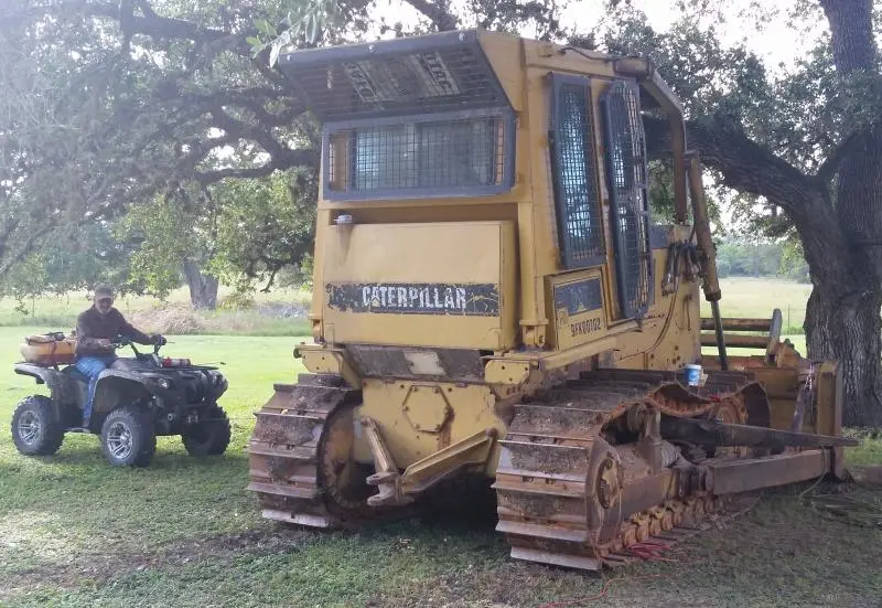

Photo 5: Preparing to install the roller stand, never underestimate the capabilities of country boys with come-a-longs!
