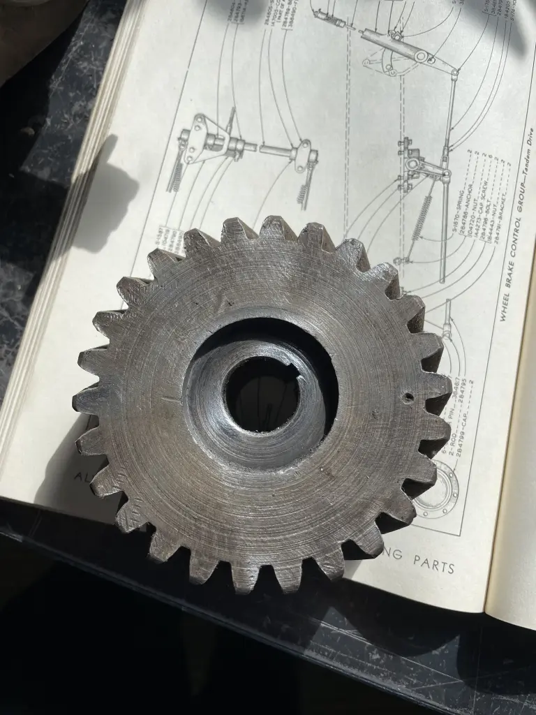

  • I have a 26tooth gear that came on the generator. The pitch is the same as the L-636 but the angle is different and obviously larger diameter than the 21tooth L-636. I’d part with it, but I can’t identify it.

I looked up a D4400 on sis and unfortunately no match. (it’s the black and white photo below)
I also added pictures of the generator itself and its Delco number.
I appreciate any help you have the time for… maybe if you know how to cross the Delco number to a cat number that would help? Also if you have an actual photo of a L-636 gear that might help me. I’m considering having one custom made at this point.

I can’t seem to get the photos to load. Delco number is 953R

Delco 953R = Cat 1B5785
1B5785 uses a 3B2770 (26T) gear (info from 4G D4 parts book (D4400)

I don’t need to create more work for you. I’m mostly just concerned that A: the generator I have, 953R is correct-ish and B: If I have a 7pitch 21 tooth gear with a 60* angle made will it fit. It’s not cheap!
