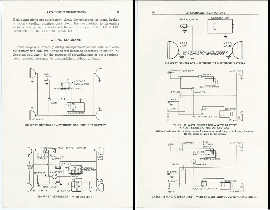

I have an R2 electric start, and front and rear lights. I need to re-wire the thing. I would like to know if a wiring diagram exists? Maybe even a D2 diagram would work?
I looked in the library but nothing jumped out at me.

There’s certainly D2 wiring diagrams in the Operator’s manual. They might get you started.

I could imagine they'd be almost identical, apart from the magneto grounding wire and switch which would only differ in location. Everything else could be the same as far as I can theorize
