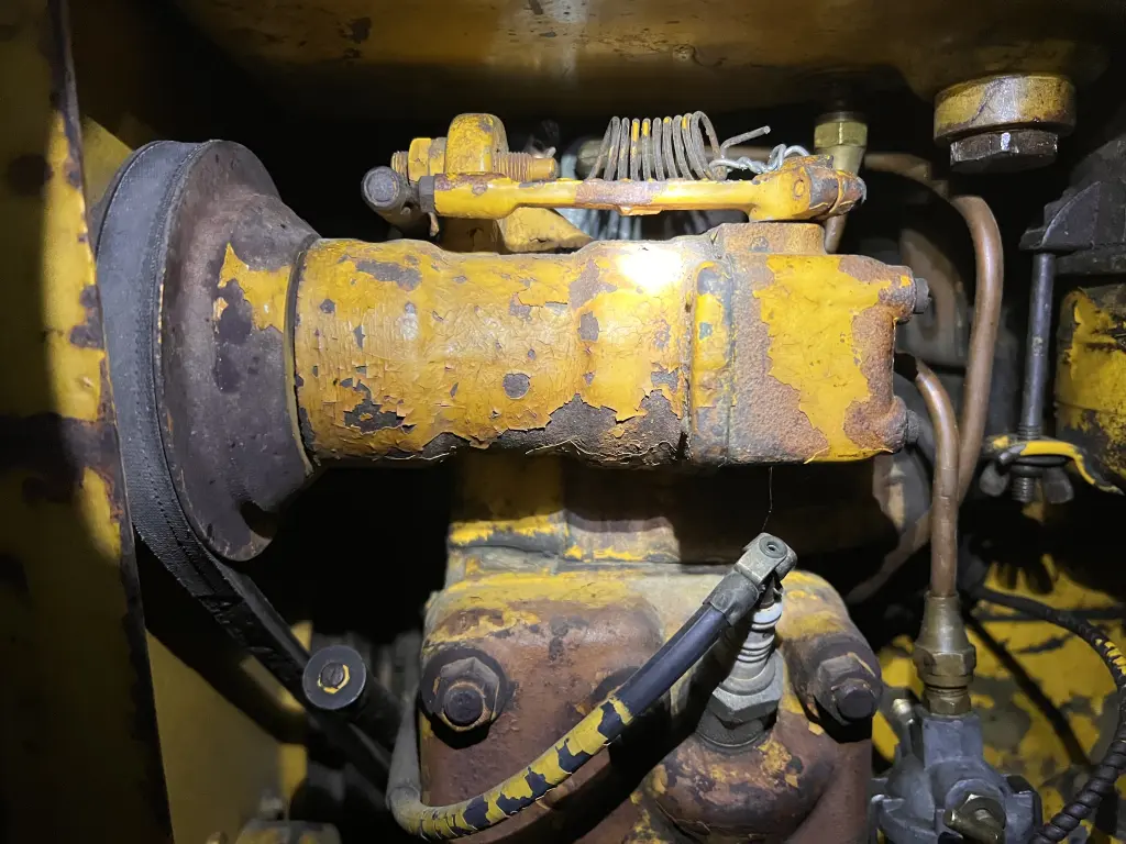

Had my pony start, run, and die, took me a minute to find the problem - broken spring. Check your governor spring. I didn't have a new one, but I did have some wire.... Got me going.

Good catch!

Have to work the lever on one of mine when having trouble getting a pony running. Should take it apart and oil the parts inside one of these days. The spring is okay though.

Dear forum members, my name is marcel wakker and I lives sinds 2017 in the VAE, I buy overhere a cat D2 without running the pony, I don't now iff their is a technical problem or perhaps I make a fold for startup, if anybody can help me for a link so I can see how to start exactly, on you tube I cannot not see it very well how to start.
Hope one of you can help me, thx in advance, best regards Marcel

This video might help:
https://www.youtube.com/watch?v=Jcz7qPz8QTE

Some instruction I have seen recomends removing a screw from the face of the pulley and filling with engine oil every so often. Don't ask me how to get to it, probably why it seldom happens. cheers WF
