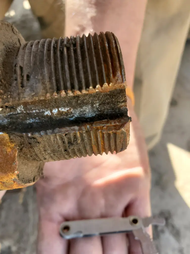

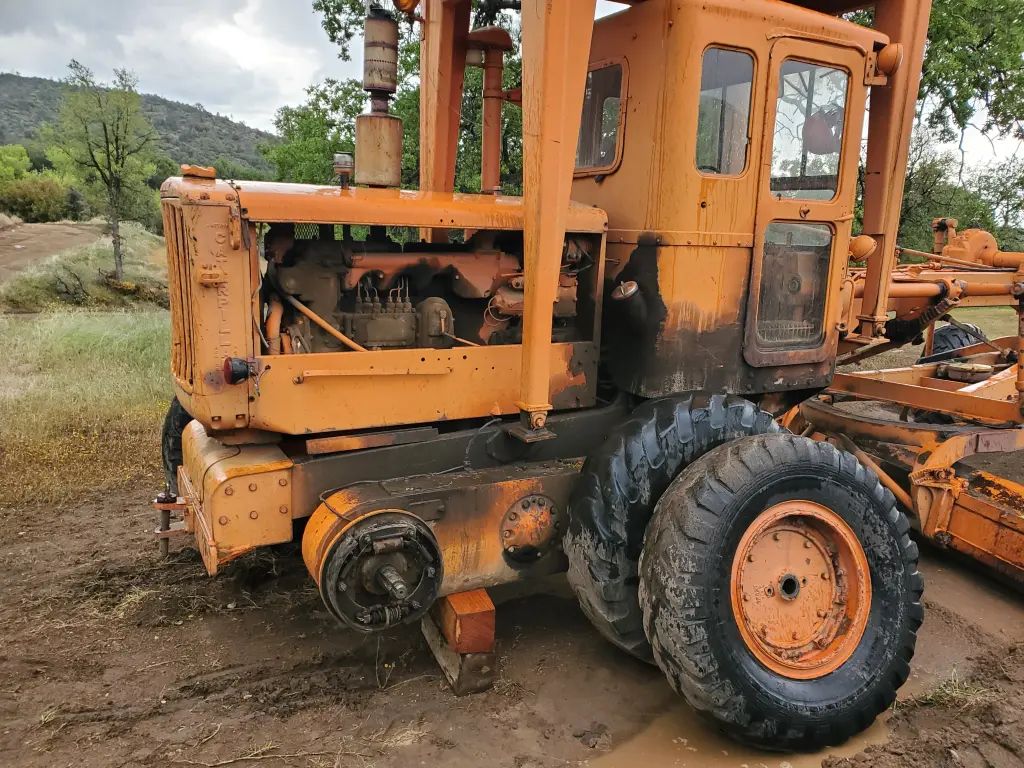

Long time reader first post as a member.
Thankfully this happened on a fire break, not on the main community road (ROAD CLOSED LOL)
As title says, damaged the spindle on way off. Came off like a gunshot BAM and I dropped 20".
According to the grader owner (my 100 yr old Grandfather, who ran it until age of 90+) our grader is a 1954 cat no 12 road grader. Serial number 8T11692
Also somehow popped a tube on opposite side of grader rear left at same time.

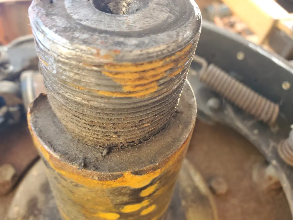

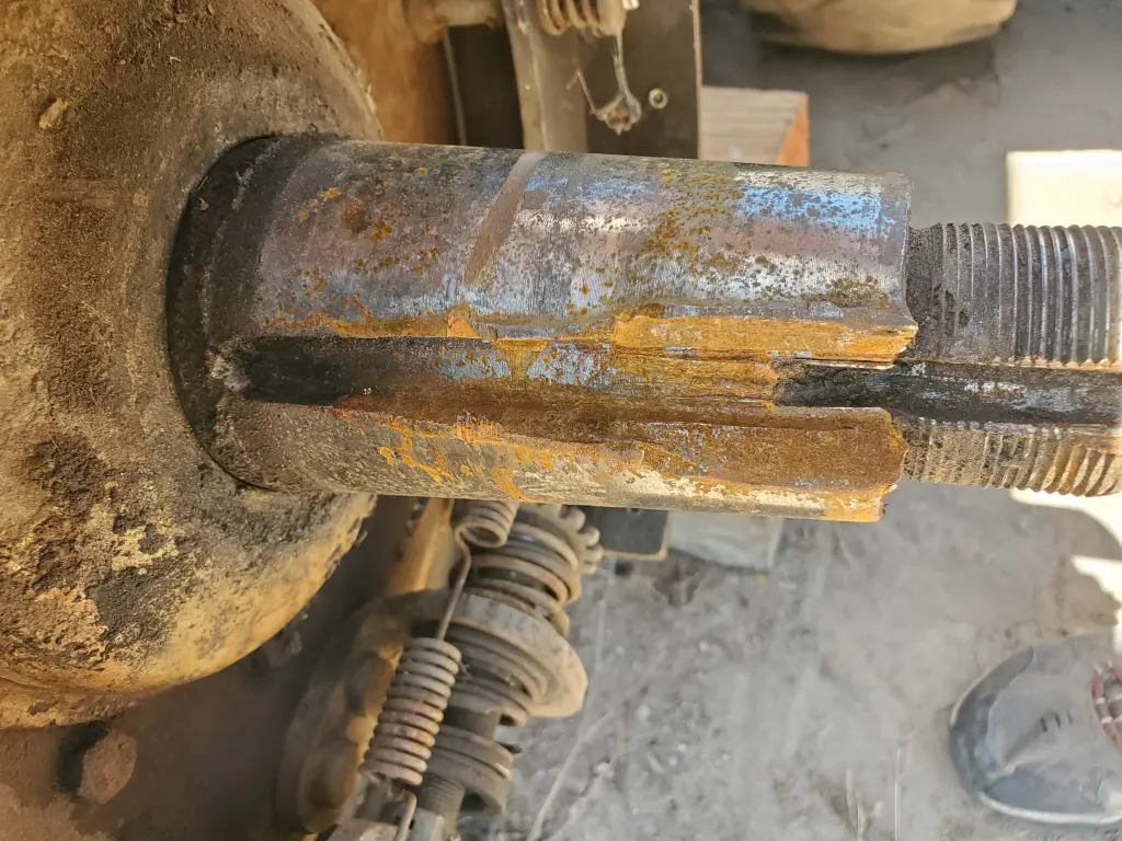

Sorry for individual pictures, only way I don't get the broken link image or whatever it's called.
Anyways, bought a set of 4 books to help out with this and it simply summarizes the job as "replace wheel and drum on spindle, tighten securely."
I've read here wheel should be pressed on at 40 TONS...
Also, opinions on spindle keyway, opinion on threads, any help and time appreciated.

josh
Posts: 1,207
That spindle, 4F3942 is junk, you need to find a new or good used one, the wheel assembly 4B2737 may also need to be replaced.

Hi, CalienteJohn.
I think Josh is right, you need a new GOOD used axle and hub to fix that. You will also need the hydraulic press and fitting to press then together. While you're at it, it'z probably worth checking the press fit pressure on the other 3 drive wheels while you have the gear to do it.
