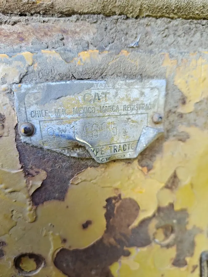

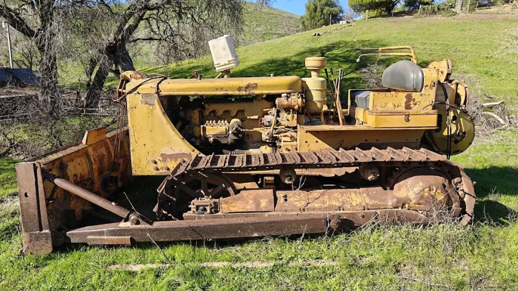

Sure, it is a small world isn't it? He bought a property in Fairfield that belonged to a gentleman named William Green. If anyone knew the man please don't hesitate to share. Here's a couple photos. I'll add more as we progress (time permitting).
Nice looking machine. Electric start pilot motor is always a bonus. Good luck with it and keep us updated on progress please, we are all interested.
Sweet! One of our chapter leaders (Brett Atkinson) lives in Vacaville, CA might be a good in the flesh person to help out on occasion. He isn't familiar with the previous owners name, but he has done a lot of site prep, you name it by Lake Berryessa, Dixon, the entire Solano County area. Myself, I am a Sutter County person, only 1.5 hours from that area. We would love to help out in any way we could. (530)Four one five-0504 if you wish to call or text. Have fun with your D6, one of our favorite machines to operate. JM
Good looking machine for being 70 ish years old. With just a bit of luck there should be some hours of use left in that machine.
