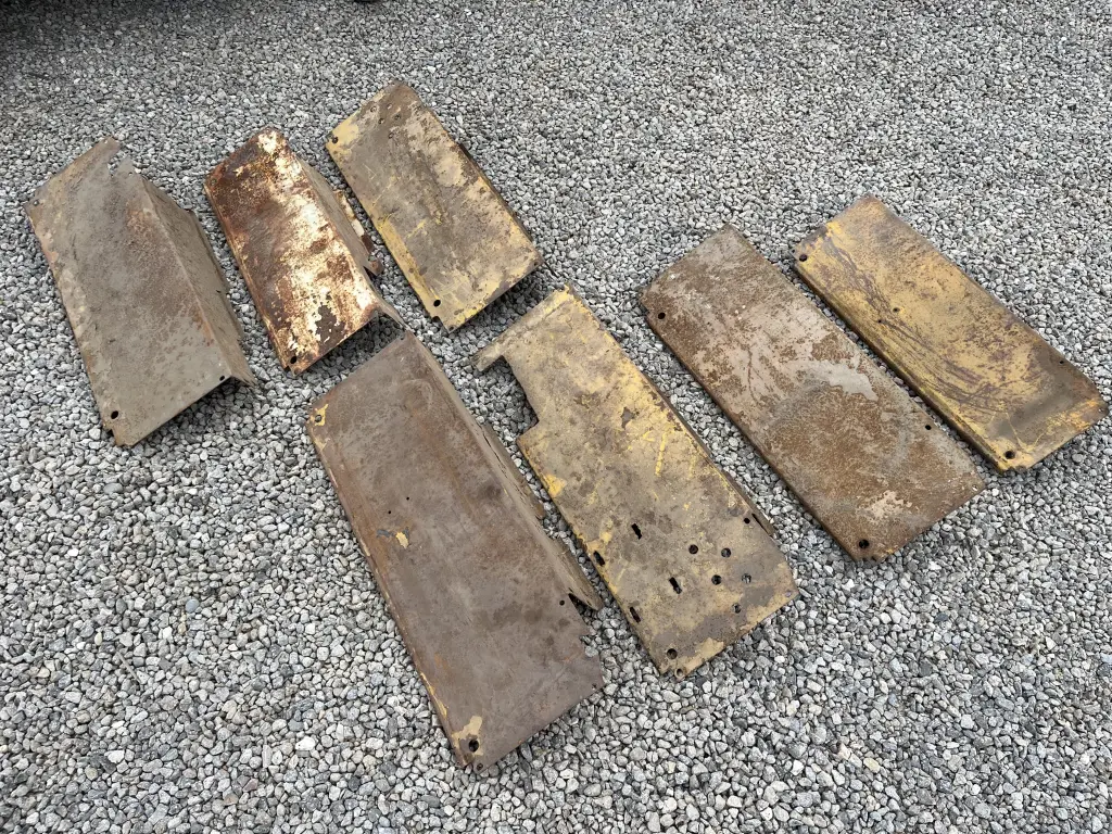

Hello everyone,
I was given 3-4 sets of engine side covers / sheet metal, which I believe fit a Twenty Two. If anyone can confirm characteristics or dimensions, to help ID them, it would be much appreciated! I will try to post pics tomorrow.
Thanks much,
Breadler

Depending on which one you show;
A Twenty-Two would be 38 15/32" long X 13 1/2" high on the outer face X 7/8" leg and no offset at the top edge
The PV Fifteen would measure : 38 1/8" long X 13 9/16" tall , 1/8" offset and 3/4" leg
The shorter ones with the offset appear to be from a TEN . Those would measure 34 11/16" long X 12"tall , 1/8" offset and a 3/4" leg
