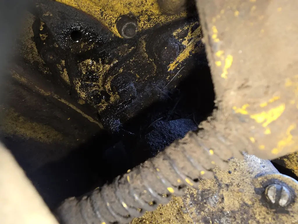

Any idea if this missing bolt would be the cause or just exit wound? I would also it like to replace it, anyone kbowbthe bolt size needed?
Mon, Jun 23, 2025 12:46 AM
Posts: 2,430
Thank you received: 52
possibly 5/16 or 3/8 unc. all bolts on these are unc or unf.
if you have a parts book you can look up the part number for the bolt. and get the specifications. then go to your local bolt shop and buy one.

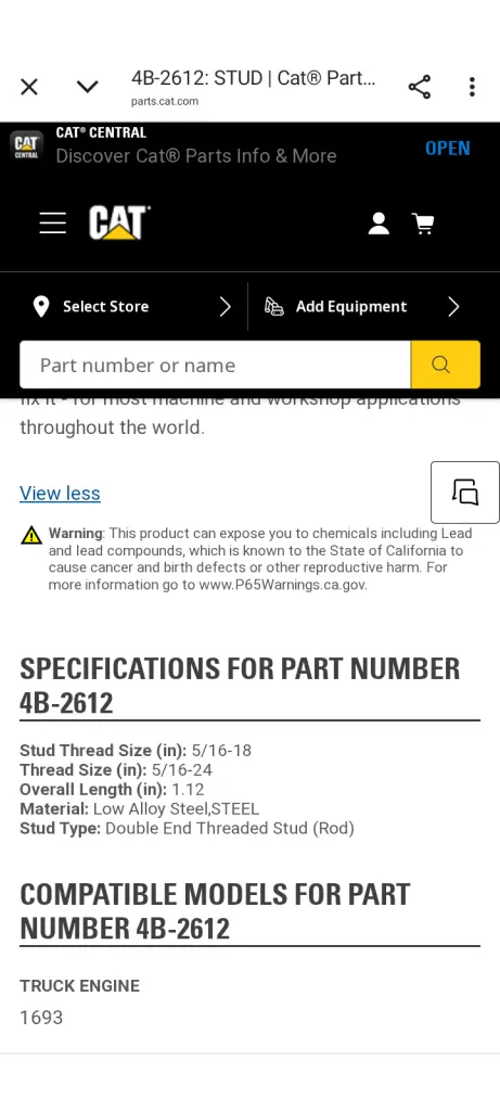

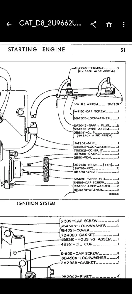

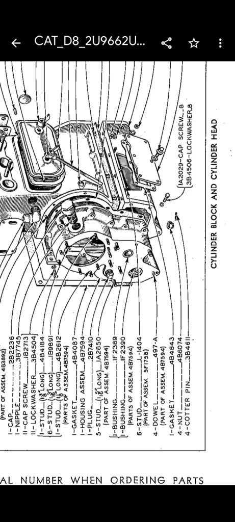

I'm going suggest that it is probably a stud and a nut, rather than a bolt. Here's a couple of screenshots of the parts diagram for a D8 2U starting engine, it should be the same as used on the D7 3T
