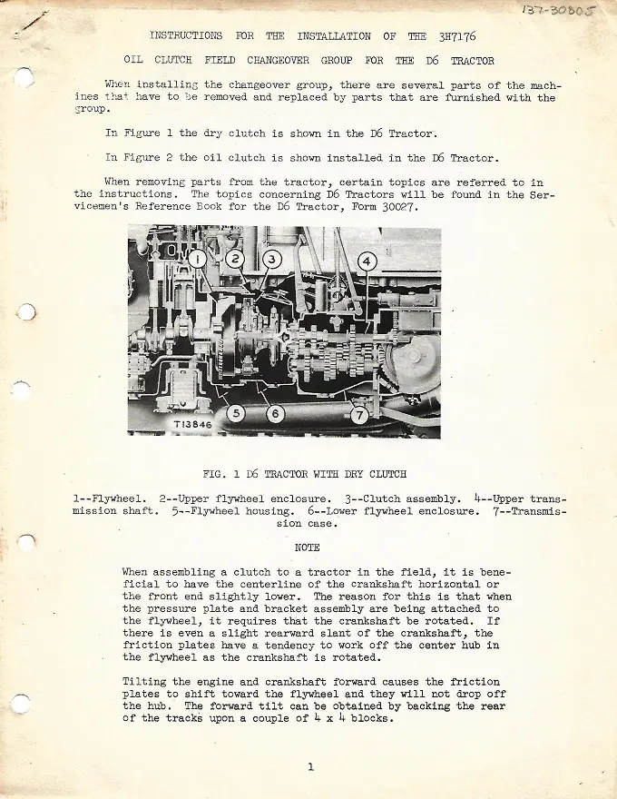

Here is a couple of pages of a Special Instruction to do oil from dry conversion--lots of expensive parts and from memory not applicable to ALL dry machines. There are some 14 pages to this Instruction. I have tried to load two pages and got into more trouble than the early settlers.
Tue, Apr 7, 2026 4:48 AM

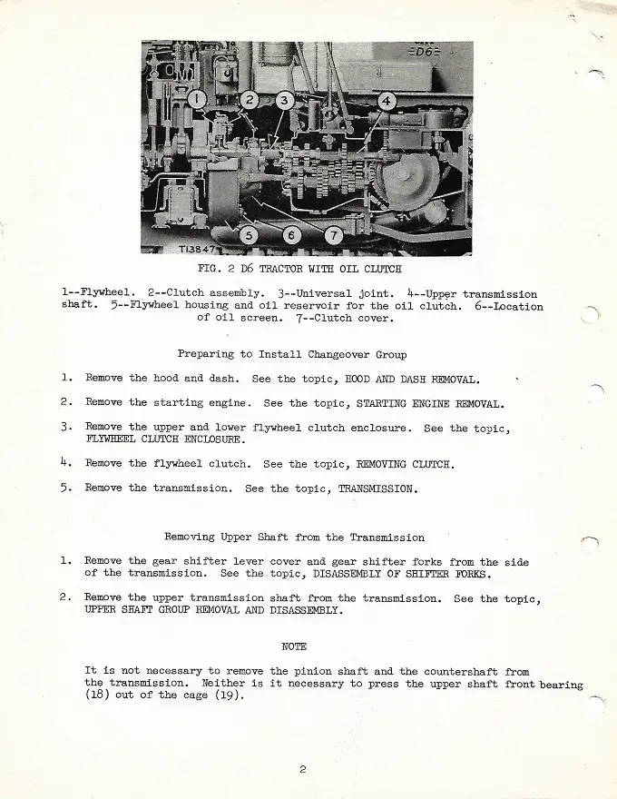

Posts: 4,250
Thank you received: 95
Page 2
Tue, Apr 7, 2026 4:50 AM
