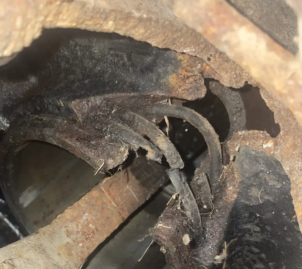

Hi well I got into this engine it’s not what I wanted to see, was wondering on thoughts of trying to fix it or just start looking for an another engine. Here is a picture of the damage!

View from the bottom up, side of the liner is gone, looks like most of the block casting is gone too, picture just begins to show what has occurred and the full extend of the damages. Could be much more extensive than this one picture shows. There are machines out there - find an eligible donor and be happy to start with something that is fixable. Go back in the forum for sale, there were some not too long ago looking for new homes. -- cts
