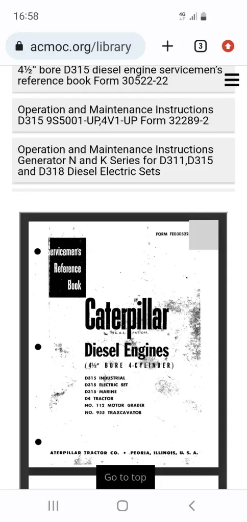

This is the book you need for the d315 engine it show how to time the engine.
It is in the technical library
 [attachment=72468]Screenshot_20230528_165814_Chrome.jpg[/attachment]
Regards
yes thats the book i was thinking of.

Reply to trainzkid88:
The book pointed out by Daryl confirms the information you have posted about finding top dead center. It also confirms 1.736 as the setting and not 1.734 although 2 thou is probably not going to make much difference..
