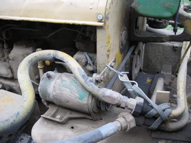

The man I brought my tractor from had rigged a starter/generator off a old lawn mower to have electric pony start. I just use jumper cables to conect and its saves a lot of climbing off and on for Senior Citizens.
