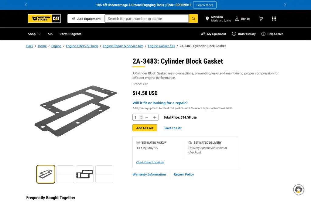

Cat Parts . Com shows this gasket is still available. They even list a 'set' in the frequently bought together if you scroll down.

Boy that's helpful isn't it BlueOx - those are most of the gaskets needed for the D2/4 pony - pretty good!

I thought the Frequently Bought 'suggestions' were a nice touch, but next time I'm buying two and setting one back.

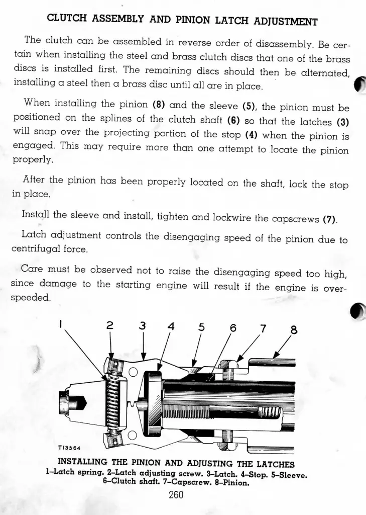

sounds like what Hector describes (item 4) has come loose, or the 4 bolts (items 7) retaining the sleeve (item 5) to the pinion (item 8) have fallen out or are loose--not uncommon, or the rear shaft bearing has failed.
If you take the assembly apart be sure to align the latches to the larger diameter of the stop bolt (item 4) or else the pinion cannot latch over--the latches must not align to the flats machined on the stop bolt head--adjusted by verniering the sleeve (5) on the shaft splines to try for best location with full latch contact.

Eddie B. Can I ask where you got this image from? I have a parts manual as well as a service manual, but the service manual only relates to the diesel engine. Thanks.

from my yellow Servicemen's Reference Book, Form No 30524-2, covering:- Caterpillar Diesel Engines (4" bore, 4 cylinder) as fitted to/used as, D311 Industrial, D311 Electric Set, D311 Marine, D2 Tractor, No212 Motor Grader.
Page 260 which is in the Starting Engine section--way down the back of the book.
