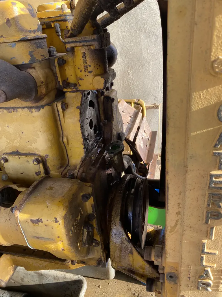

Hey all, hoping someone has some insight for me. My D2, serial 5U 17116, needs the water pump seal replaced as it's leaking. I do not have a copy of the service book and it appears none is on the forum Library either. I have a copy of the D4 7U service manual and it says you can remove the water pump without pulling the radiator, but looking at my D2 it appears the water pump has a long stud that would necessitate pulling the radiator to pull the pump forward off that stud? Am I on the right track there, as I do not really want to pull the radiator off if it's not necessary.

The earlier d2 you had to removed the radiator for remove the water pump but no need the later one

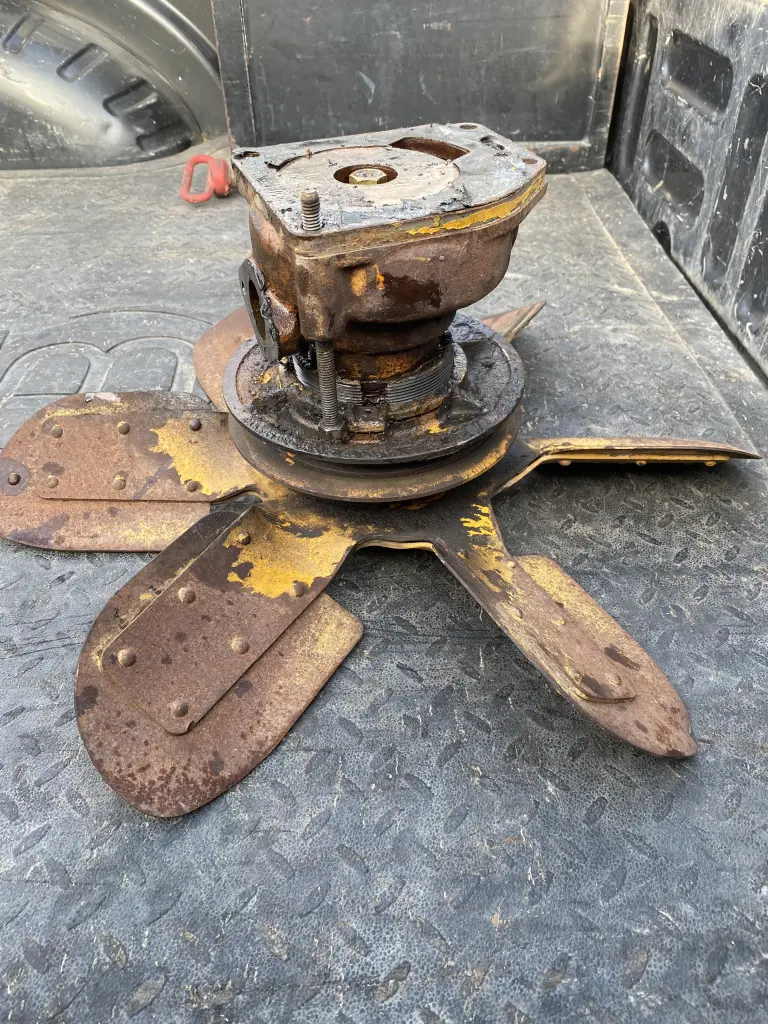

Well for anyone who’s interested I got the water pump pulled off last night in about 45 mins. I had to pull and unthread the unreasonably long stud, thread the pulley completely closed and I was able to get just enough room to slide it out the right side.

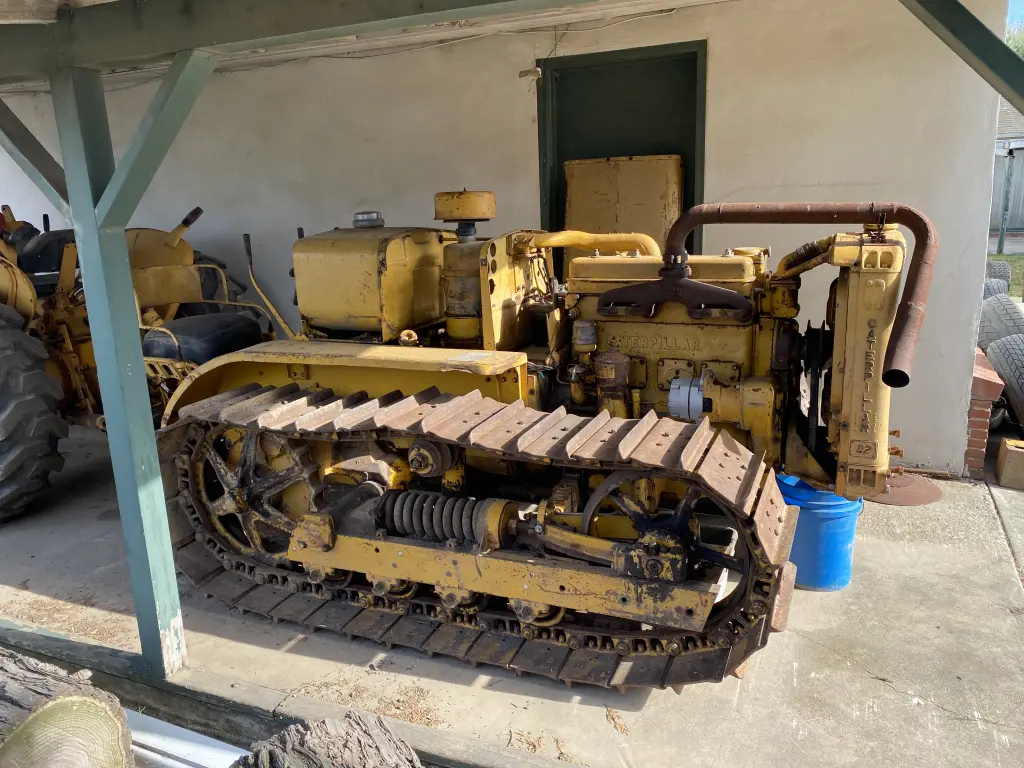

A question??? I see an alternator on your 5U. Is that an available aftermarket kit or did you have to piece it together?
Sun, Apr 27, 2025 2:52 AM
AnthonyF
Posts: 46
Thank you received: 10
The alternator was already on the tractor. I have seen lots of different ways to mount an alternator, but these are by far the cleanest and most factory looking. Unfortunately, I do not know who made the casting originally.
