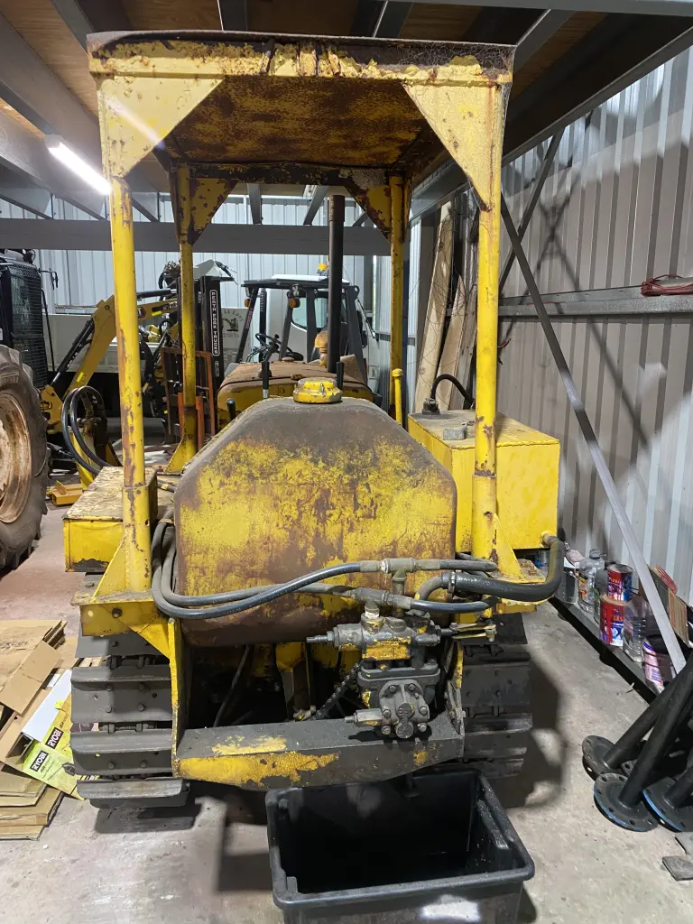

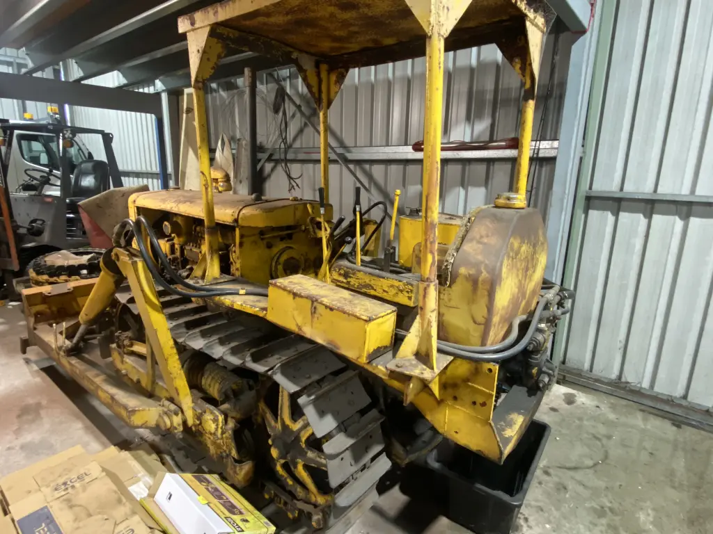

Breadler this is on my 3J 1920 in Western Australia, 1938 model machine

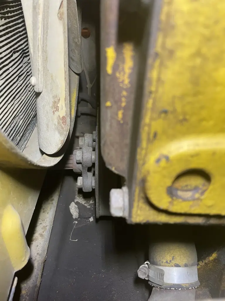

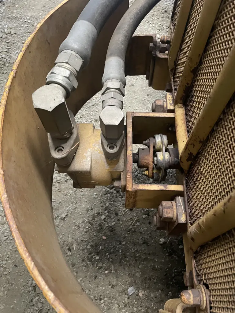

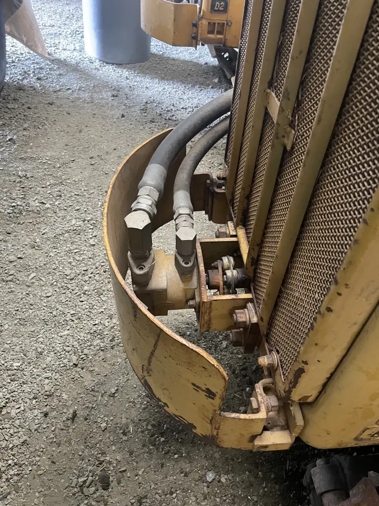

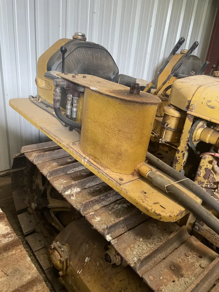

Hi Breadler, sorry I don't have any photos to hand but what I can tell you is that I have a 3J with a LaPlante Choate pump and control - the pump mounts on the rear much like the PTO or belt pulley does, and the control/reservoir sits on the right side fender. I also have, for the same machine, an adaptor that enables me to mount a #44 hydraulic control to the front. This is not something Cat offered for the J-series but it's a pretty straightforward adaptation. The radiator cover is augmented with a stout frame internally to carry the control, and the crankshaft pulley bolt is replaced with a driveshaft adaptor. I'll see if I can upload some photos of the components. The control is stock standard so no changes there
