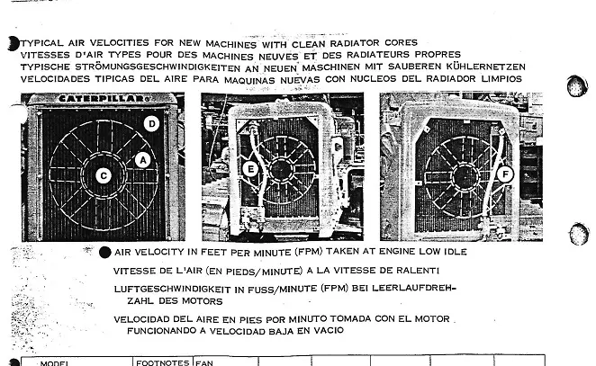

Posts: 4,250
Thank you received: 95
Hi Team,
also suggest putting a shop light or such behind the radiator core and look thru the core from the front to see if the fins are clogged with dust--you will need to move the light from radiator section to another--if the air cannot pass thru the fins it cannot cool the coolant in the tubes.
Seems something went wrong with my image posting and this was not an image I wanted, maybe things have changed since I was last here--sorry.
The posted image gives you and idea where are velocities vary over the core face.
