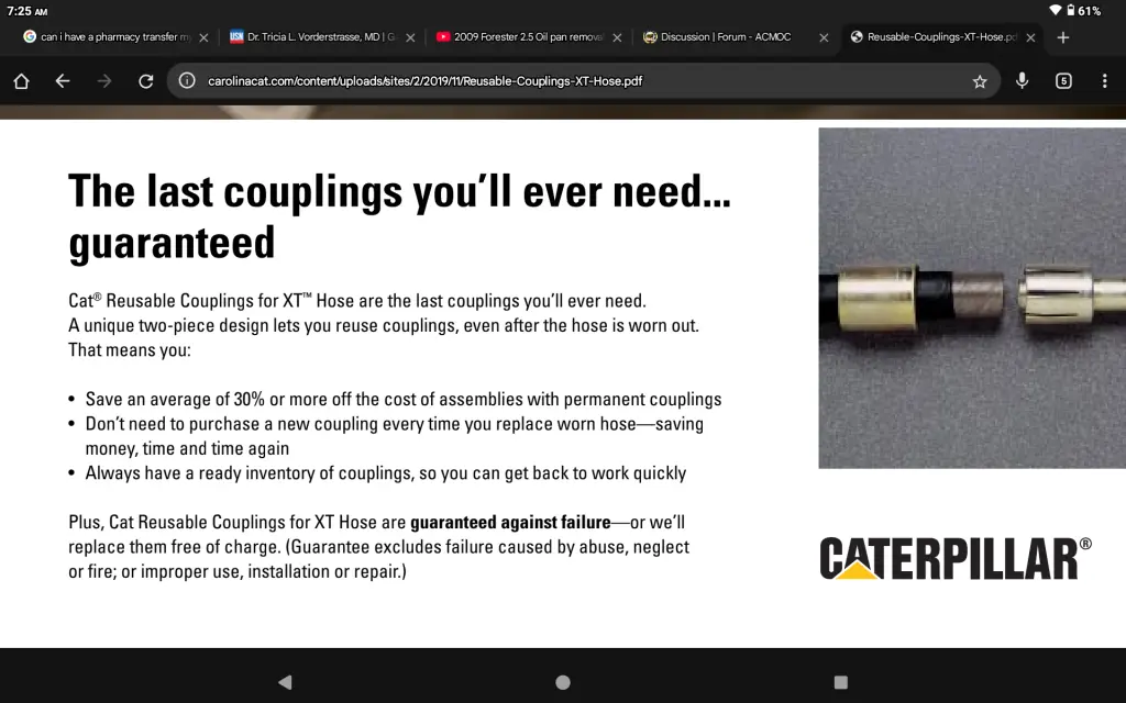

I am wondering if reusable fittings are still being used/serviced , I have a cat 922B front end loader that is in need of 4 new hydraulic hoses that uses these reusable fittings and all I need is some new hose which obviously depends whether the reusable fittings can still be used/transferd onto new hose. Any info would very helpful, thanks again guys, Dan

sae 100r2 is the type of hose you need. cat also has a range of hose.https://heavyequipment.ringpower.com/media/31vhp3yh/101-edition-cat-hose-products-tooling-guide.pdf ths is the hose and fittings catalog. yes they still make field reusable couplings.
