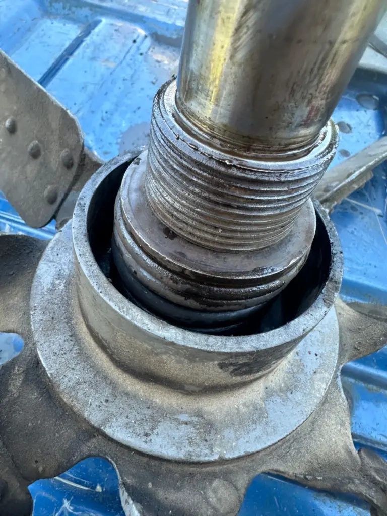

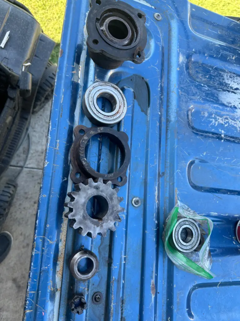

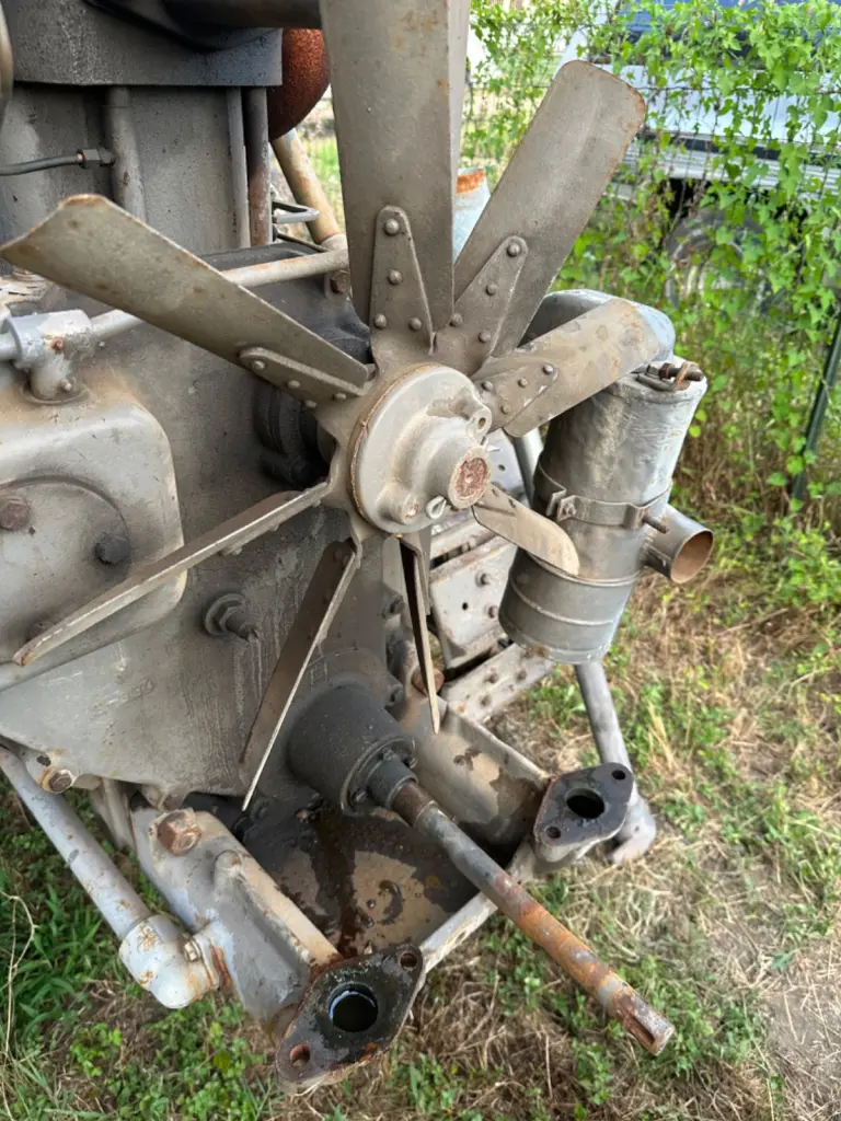

That’s where I’m going next just wanted to share some pictures…I wanted to check the bearings aswell just to have peace of mind and not go into it twice…I’m looking for the books my grandpa had on it to find the diagram for it but I’m still looking for them. I feel like there should be a bit holding spring tension on there but not sure there wasn’t one there when I disassembled it
