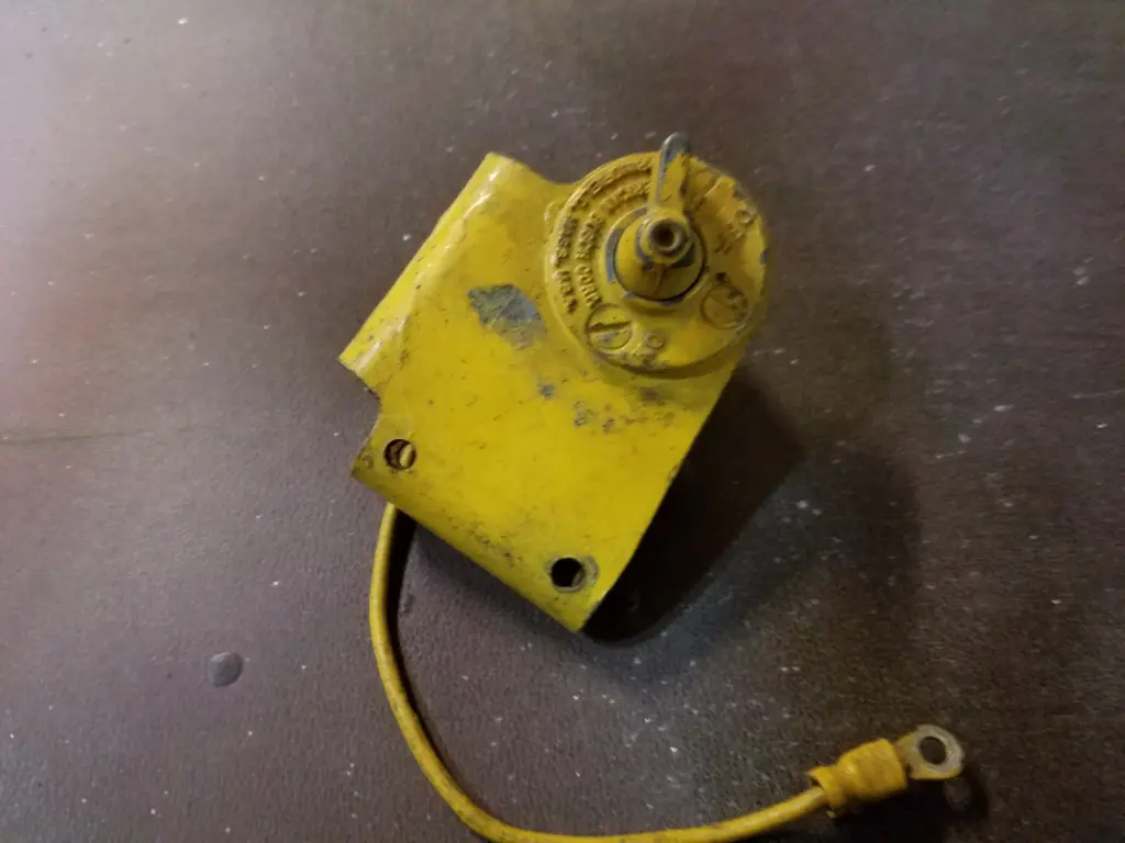

I believe this is what you wanted.  Text (573-433-nine two seven seven) me your address, if you do texting, and I will send it to you.  I agree with you 100%.  In case of something going wrong at least you have an option and yes, it is suppose to be there. Brian Boaz  [attachment=66910]20220220_103005[1].jpg[/attachment]
