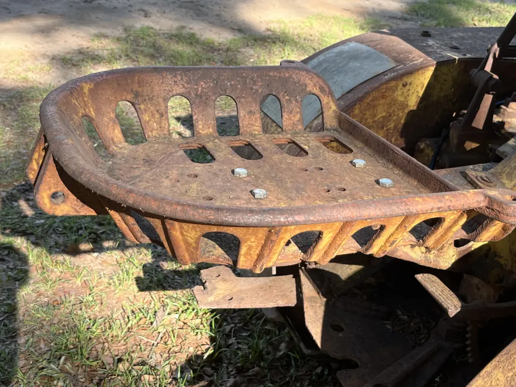

Casting number on the seat is 361A. Thanks!

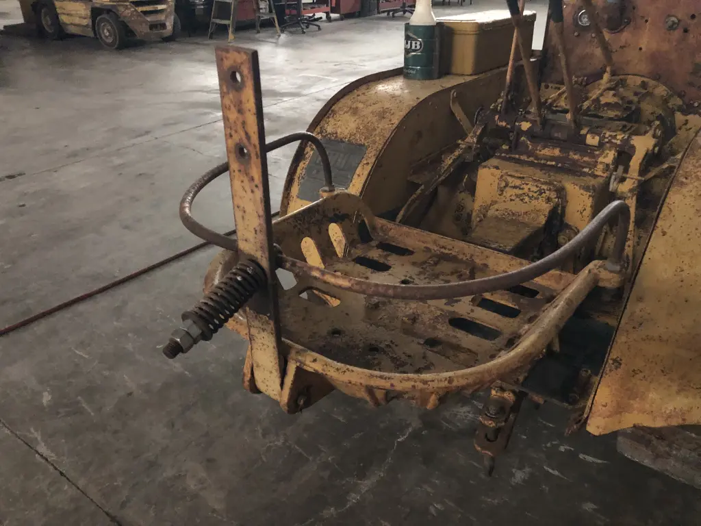

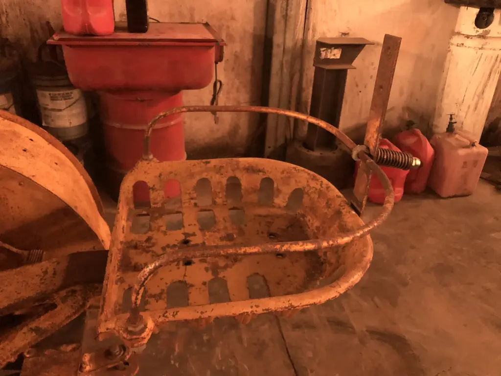

"Sandman" used to make them. I do not know if he follows this website anymore. I can post a photo of something to give you an idea.

Photo of one in case you wish to make your own.

Another angle.

Thank you Ken! If I run into a dead end here I would definitely like to have a copy of those to build it myself. The bolt that connects the rail and backrest appears to be a specialty piece of hardware from what I can see in the pics from juiceman. I have an original parts manual from the year this tractor was made but this seat is not in it.

Everything used on that rail is a custom piece besides the nuts and cotter pins.

A "good" hardware store should be able to supply the "eyebolt" and a spring, metal shop/blacksmith could bend the cold rolled and thread. This is not something that would be that difficult to fabricate. -- When there is a need, there is a way. I have seen many of these that were broken at the threads where attach to the seat. - cts
