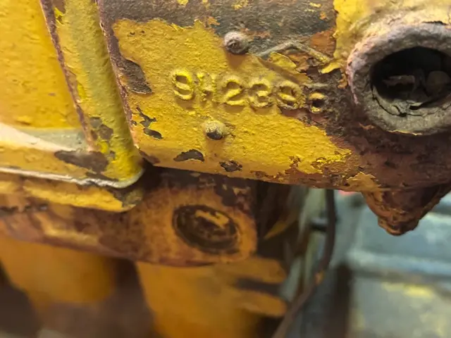

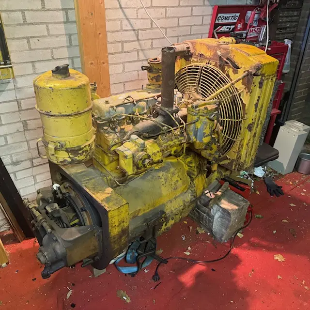

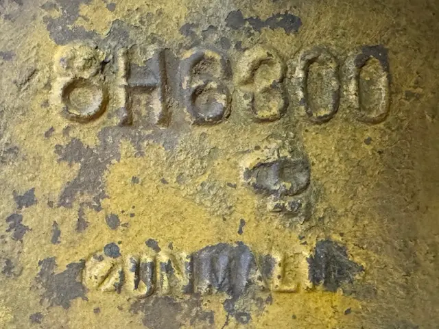

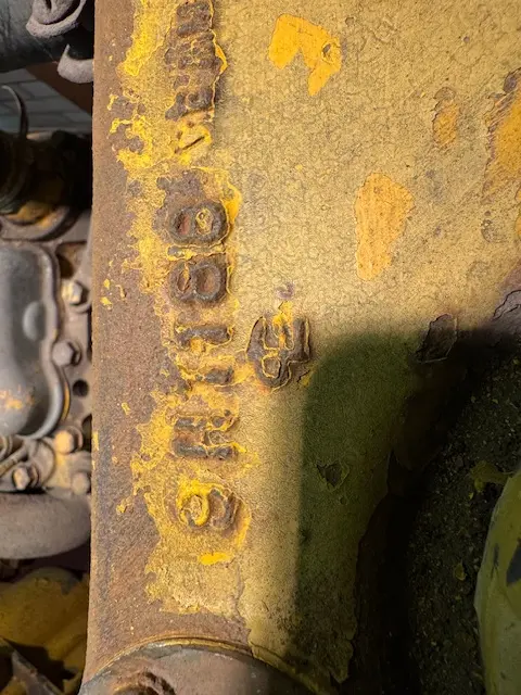

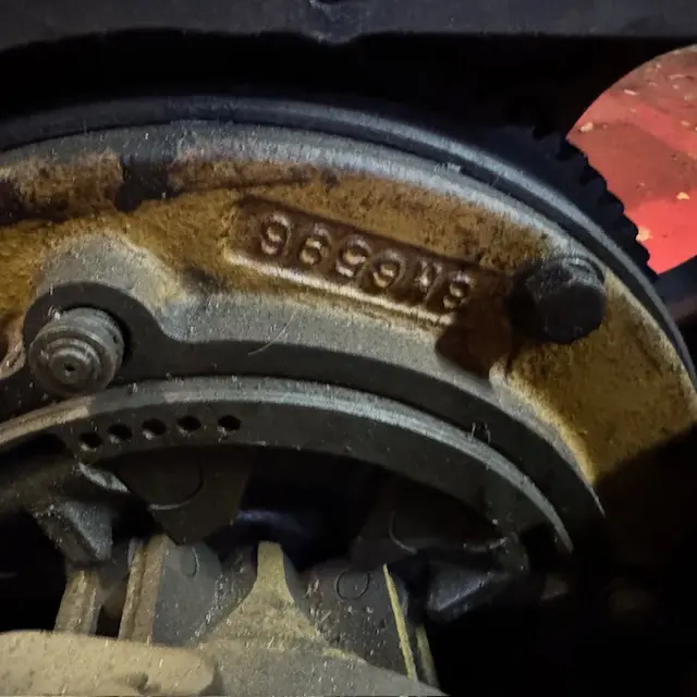

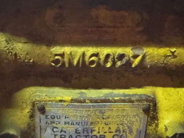

This engine came from a USA army base auction, will be sold as a whole or in parts, please send me a message if you are interested in any of it.
If anybody can help me on what vehicle this has been your help is very appreciated.
The engine is located in the Netherlands.
Wed, Dec 3, 2025 12:00 PM
Posts: 16,746
Thank you received: 37
That engine appears to be A D311H and used the 8H6200 block.
Used in the 933F 42A1400-1543 (1961) Traxcavator
