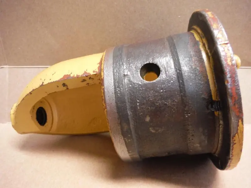

Hello to All Members:

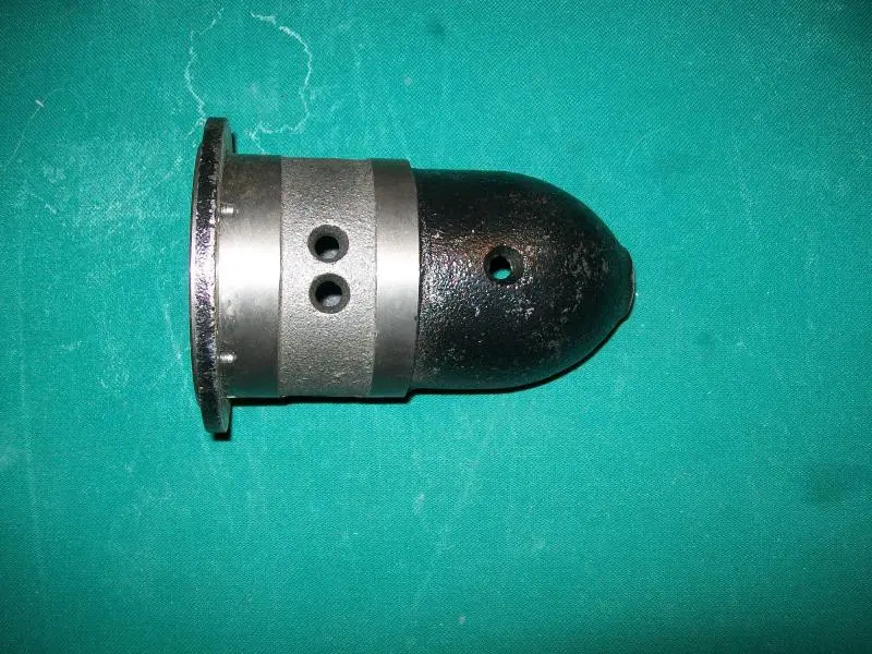

I am trying to locate a good starter drive housing for my Caterpillar D4 tractor starting motor. In an attempt to remove my electric starting motor from its pony motor mounting the starter drive housing was damaged and may not be repairable. The part is identified as P/N 9B8863 (housing assembly) and is a component of the 6 volt DC starting motor P/N 6B2861. The starting motor carries a Delco-Remy nameplate with the following information: Model 1107024, Serial Number 0G13. Please let me know if you have a good part available and what it will cost. Thanks from David at email address: [email protected]. PS: I have noted what may be a suitable replacement part for my application online. A number of companies (Steiner Tractor, Jensales, Amazon, etc.) advertise a new starter drive housing P/N ACS324 for Allis Chalmers tractors: B, C, CA, D14, IB, RC, WC, WD and WF. The text indicates that this housing fits Delco-Remy model 1107024. The diagram attached to this part measures and looks like what I need. Does anyone out there know if this is correct?

The Delco Remy part number for the drive end housing for the Delco #1107024 is a #1879156.
If what you can find matches this number it will fit/work.
I looked it up on ebay and at least one supplier indicates the 1879156 is a good number so yes, looks like you've found an easy replacement if their claim is correct.

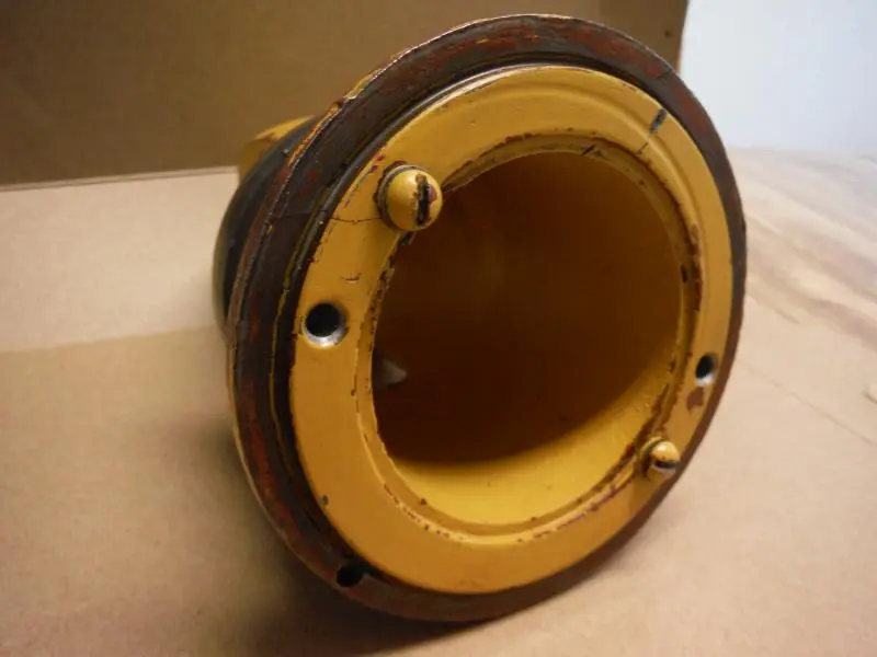

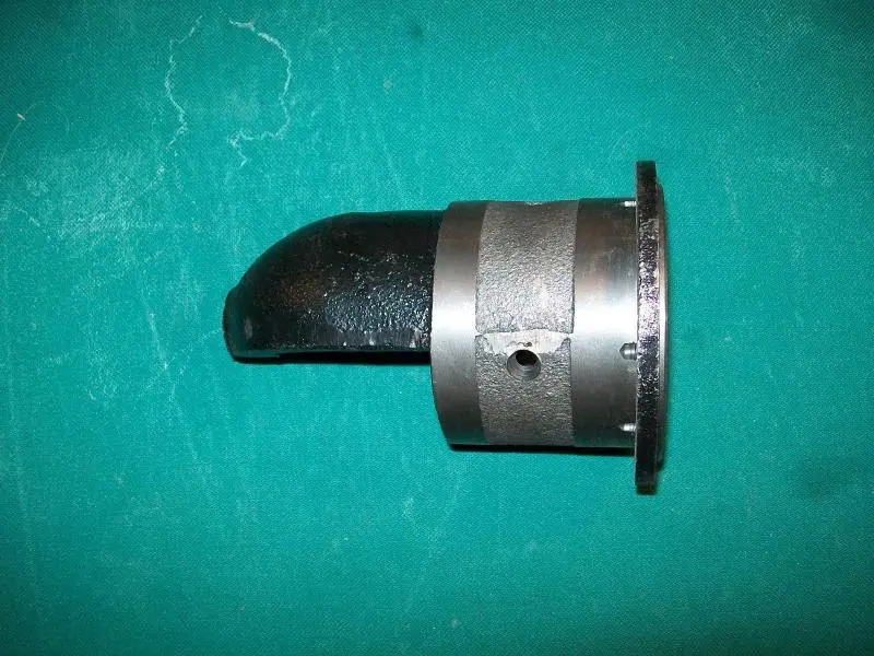

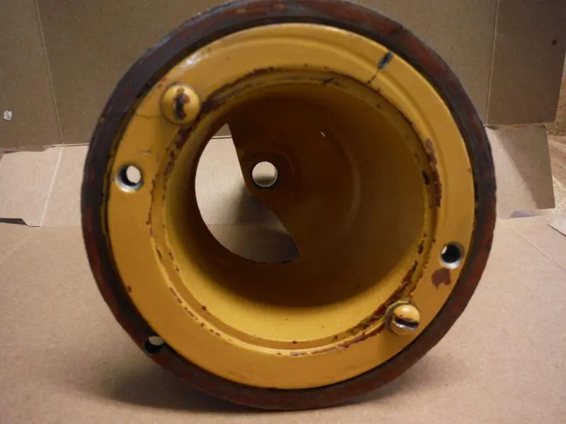

Thanks to Old Magnet, ag-mike and JoeG for your answers to my inquiry. I have contacted the ebay seller as you suggested and they claim that their housing should work. Please review the attachments showing the ebay housing (in blue background) and my damaged housing (painted in yellow). The parts seem interchangeable but I'll only know for sure by making the purchase and giving it a try. Thanks for your help and I'll let you know how it works out. Thanks from David.

looks like it'll fit several applications. put some no seize on the machined surfaces b4 putting on. good luck and let us know.
