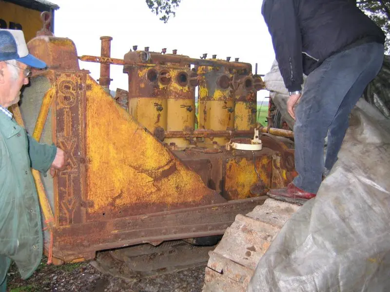

I can trade my old timer truck for a Caterpillar sixty,
But this one has a starter ringgear instead of a Original flywheelstarter, does anyone know
if its an Original item or homemade ?
Thanks Nico[attachment=20477]20131105_7.jpg[/attachment]

I would say homemade

Can you post some pix of the starter set up?

Looks a bit like a DIESEL SIXTY main frame with a Gas SIXTY engine and radiator to me, need some more photo's to verify if my first impressions are correct.

With closer inspection its a gas SIXTY with a home made starter setup
