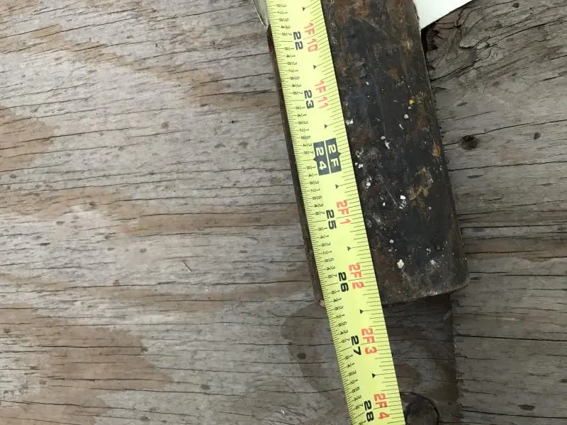

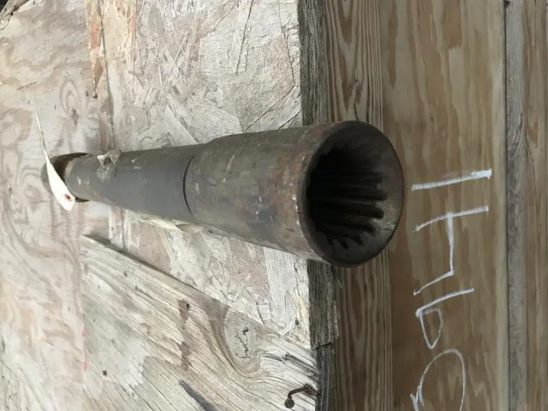

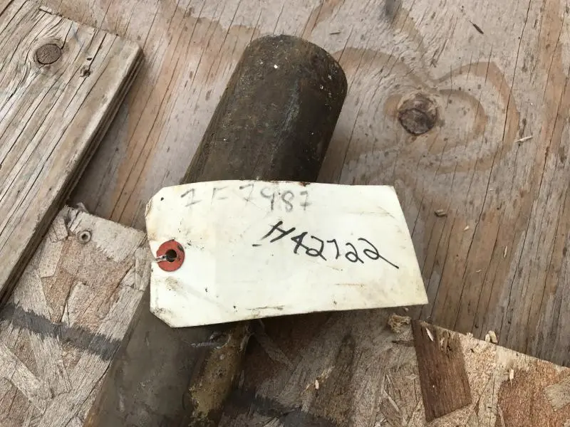

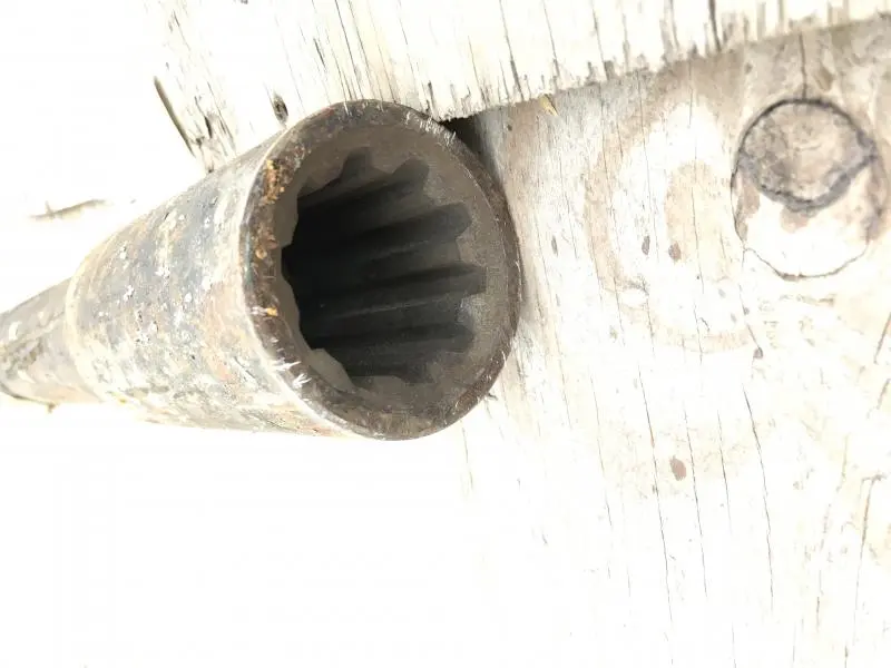

Dph,
I have a part # of 7f-7987 or a H4-2722. The shaft is 26.5". Maybe OldMagnet or someone can chim in on part numbers. [attachment=41504]IMG_3679.jpg[/attachment][attachment=41503]IMG_3674.jpg[/attachment][attachment=41505]IMG_3677.jpg[/attachment][attachment=41506]IMG_3676.jpg[/attachment]

7F7987 is part of an adapter group, for mounting a #25 DD cable control on a TD24.

I'll double check my measurements but we were at 24.5 or 24.25 inches. The female coupler for the grace track pump has 14 splines and the shaft it slides onto measures 1.25 inches. It's a common coupler, I can source it if we make our own shaft. I'm having trouble sourcing the female coupler that goes into the back of the 8. It has 10 splines and slides on a shaft that measure 2 and 3/8. Thanks.
Should add the diameters were taking with a ruler. I'm told a shaft to run a winch would be shorter, with identical couplers of the larger size on each end. I don't know what the shaft for the ccu had on the outside end.
