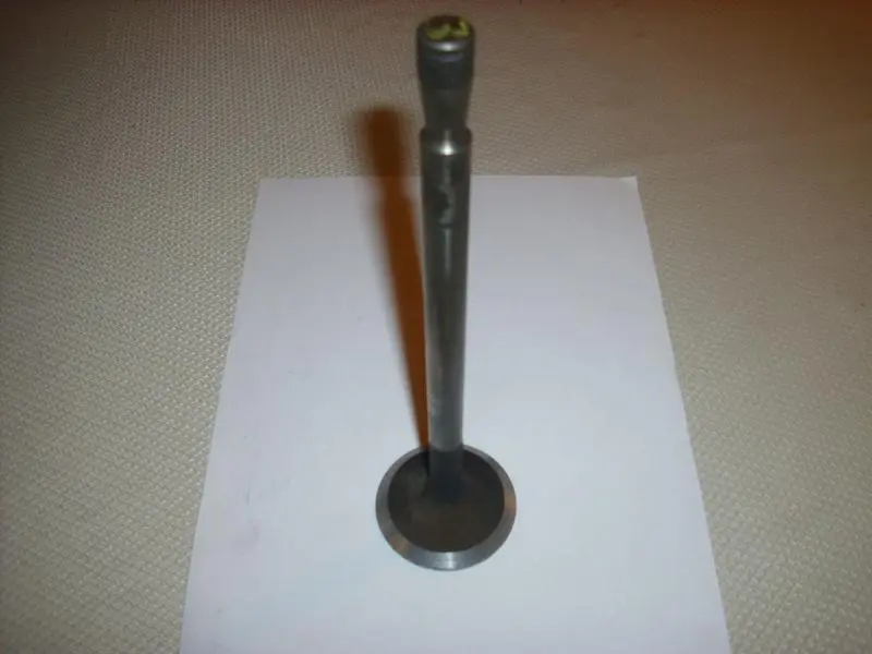

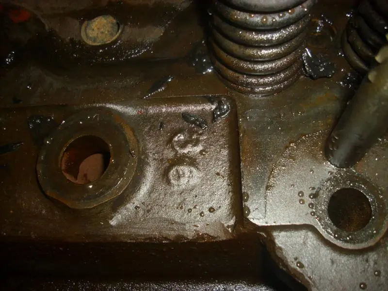

Definitely the late head. Let me know on the valves and I can get a pallet out this week.
Chad Enyeart
Mon, Sep 26, 2016 6:45 AM
scooter3
Send a private message to scooter3
Posts: 53
Reply to WyoCat:
Chad,
I just removed the valves. I am glad we brought that up. It is amazing what damage water can cause. I knew this head leaked water after the repair 20 years ago. I drained the water while it was running to keep it out of the oil, but found that did not work. I used it to build my house and a motocross track for me and the kids. Since then, we would get it out and play each year.
I will send you a PM with my contact information.
Thank you,
Scooter
