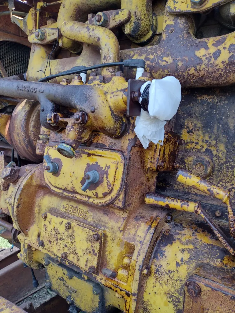

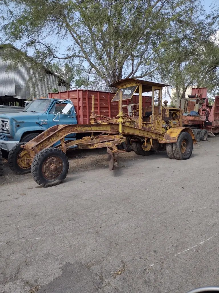

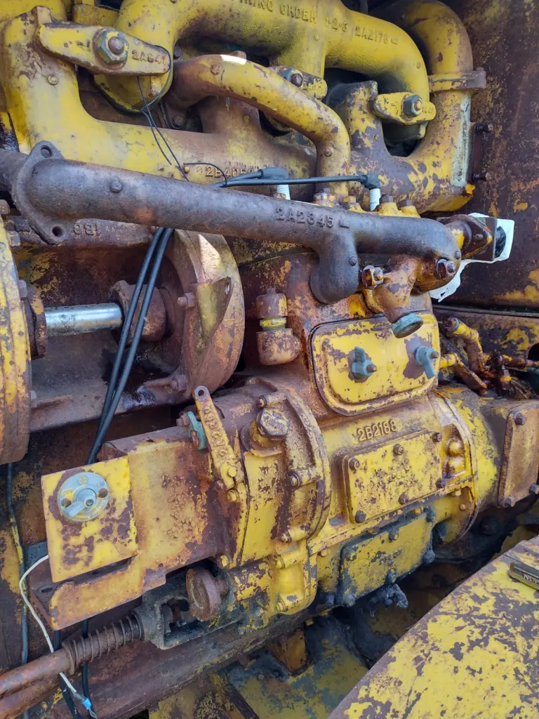

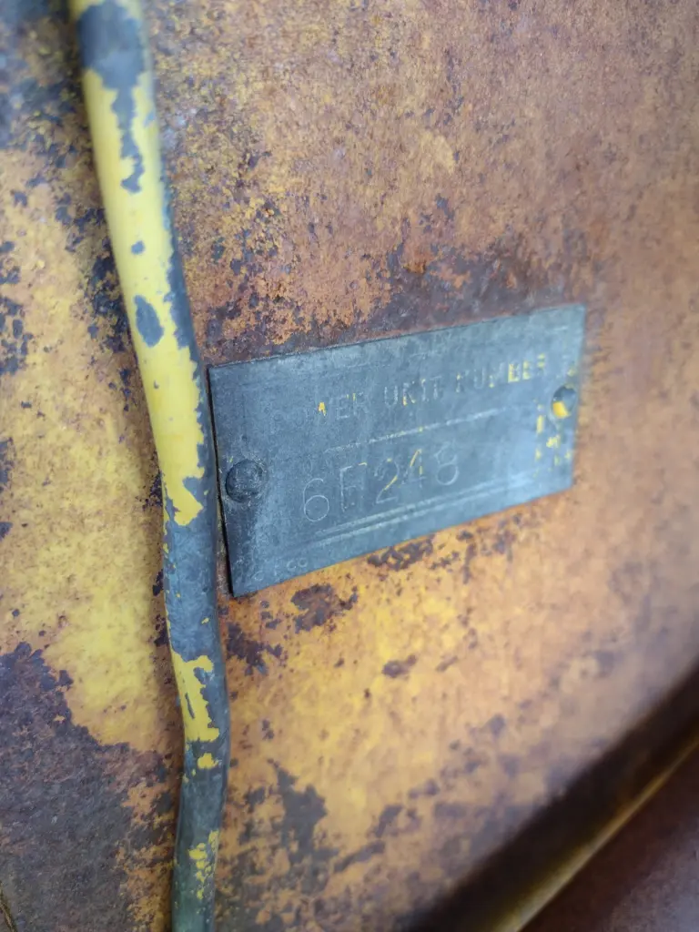

Hi, I'm new to ACMOC. My father was a member for a long time. Since he passed I inherited his No.11 Auto Patrol. I wanted to see if it was possible to find a horizontal side draft pony engine carburetor. For some reason it seems everyone has the downdraft carburetor. Is the side draft more rare? The engine number is 6F248. I couldn't find a chassis tag on it. For last 30 years or so he had a 2 cylinder onan carb fastened to it with a homemade adapter, which seemed to work alright for it. Judging by all the info this seems to be a 1934 or 1935, but don't know for sure. Any info on that would be appreciated and possibly finding the right carb would be appreciated also.

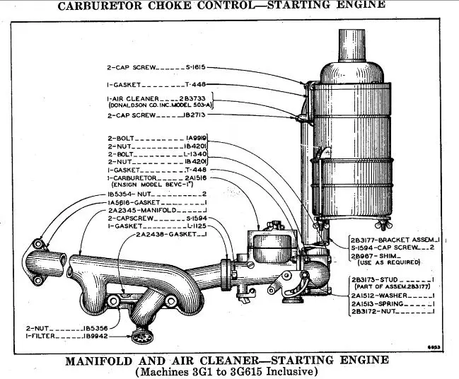

 [attachment=77266]40 3g -1.JPG[/attachment]

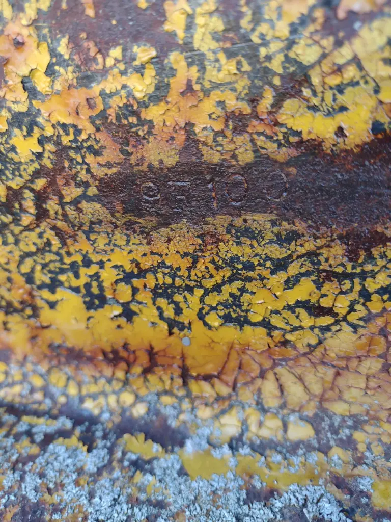

 [attachment=77271]a9eddcaa855ae82c5917c2a2f8f68b50[/attachment] I found the chassis number today, it is 9F100, so a 1935 with the 6F engine.

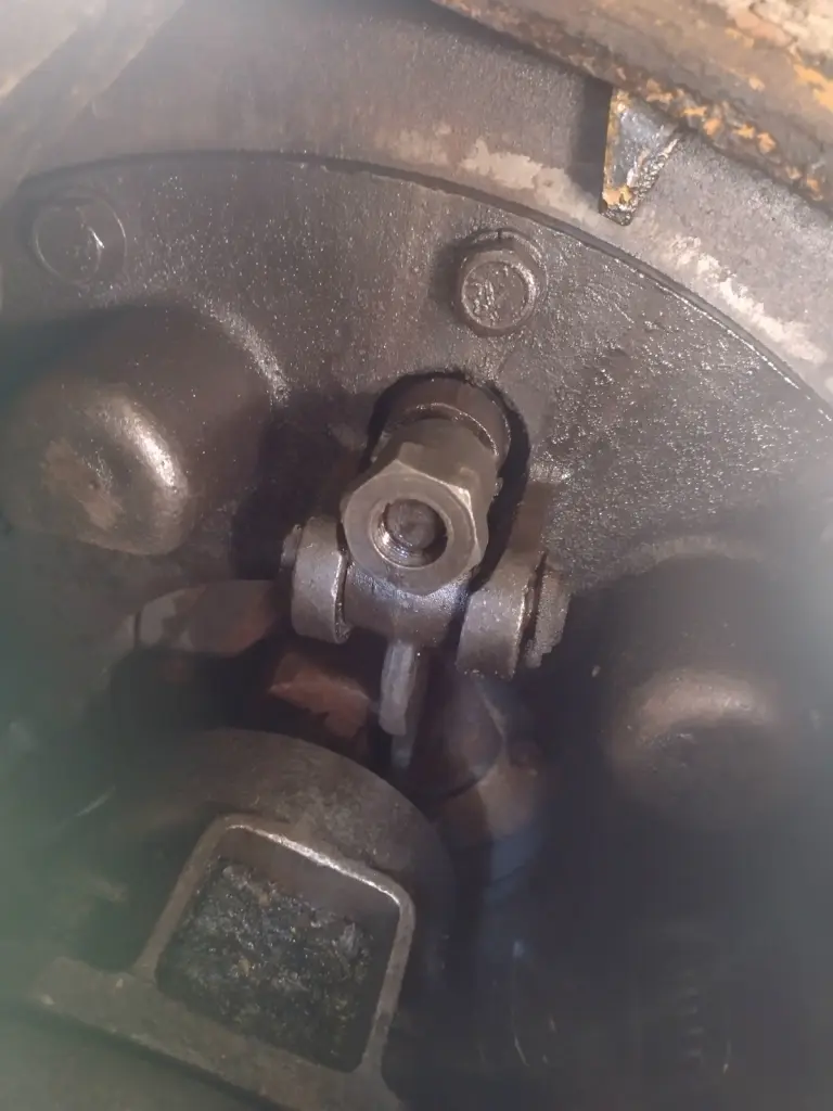

 [attachment=77563]IMG_20240903_153931547.jpg[/attachment]So would anyone have any extra clutch parts for sale for my diesel 11?

I think I would just need levers and pins. The lever must be bent because no matter how much I tighten that nut it is still a good half inch from the throw out bearing. It also all comes loose again on just that one lever. I had it working but it came loose and Im at square one again. But I'll have to look at some numbers because this is a 9F machine with a 6F diesel. D6100

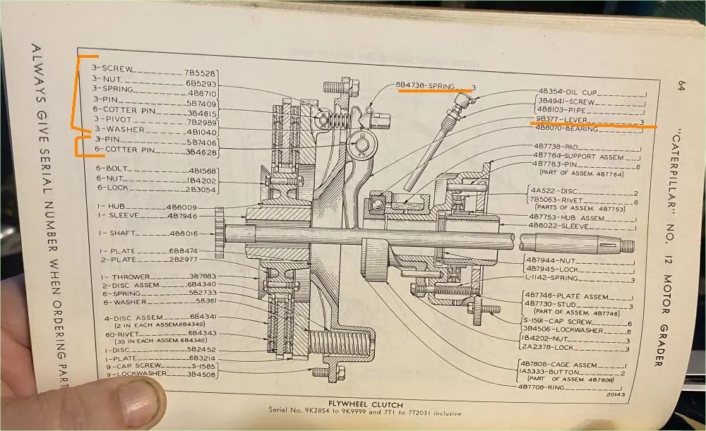

 Looking at your picture and and rereading your post, I can also see not only the lever (9B337) but the nut (in my book 6B5293) or the screw (7B552😎 could also have stripped threads causing your unwanted self-adjusting
FYI  Early models designated "No.12 Diesel Auto Patrol" were renamed "No.12 Diesel Motor Grader" mid-year in 1939.
[attachment=77574]Img_4418[1].jpg[/attachment]
Form UE332970
9K2354 - 9K9999
1940-45
In that picture I had just screwed the nut back on halfway. The threads on both look fine and it gets tight, I used a half inch drive, foot and a half long, snap on ratchet, it was tight. Lol. But even doing that there is like a half before the throw out bearing even touches that lever. And the other two have full movement and are engaged right when you push the pedal. But I did notice that it looked like the lever was riding on the splines of the shaft. Almost like the pin and lever are wore out. I'm just going to have to take it apart and see.

what has happened is the disk lining is falling apart. which has been the case for at least the last 30 years since he always had to "grind" it into gear. which we though was from pull starting which i have found out is inacurate. you can pull start without ruining the gear stop clutch. the clutch lining has fallen off and layered on top of itself causing a not fully disengaged scenario, no matter how hard you press the pedal or adjust it. anyway who religns clutch disks?
