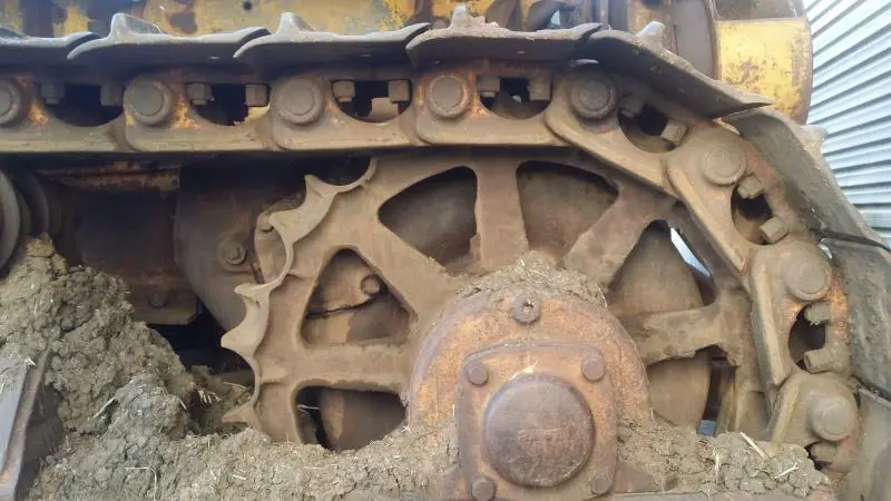

I am looking for new sprocket segments for a d8 2u serial number 21902. The shop I am using has located two new ones in Canada for around $550 each plus $500 for shipping to Missouri. $1600 total. I am new to this dozer ownership! Does this sound like a fair deal? If anyone knows where I can find some for less money please let me know. Thank you.

I am looking for segments, rings, or sprockets. I just want to find out what is available and what they cost. The shop has located sprocket rings. They say my sprockets have never been cut on or welded, and the centers are good. I would like to stay with the 8" pitch as I have another complete d8 2u that has a bad transmission(no 1st and 2nd forward- all other gears work) but excellent rails, pins, and tracks. The plan is to swap the tracks but my sprockets need replaced. Thanks for the part #s Old Magnet

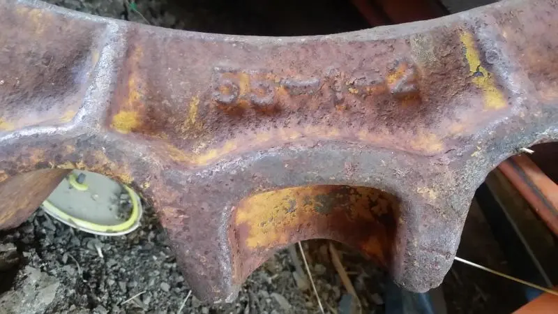

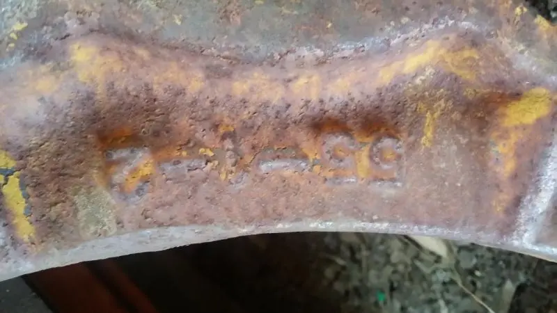

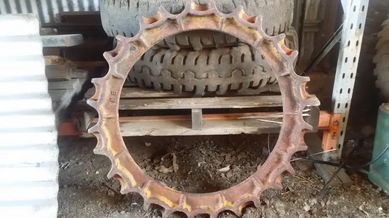

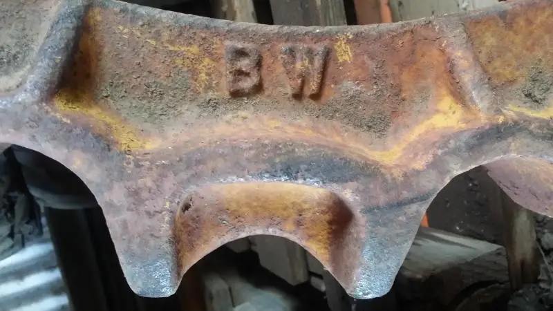

This doesn't help you but I picked up this rim at the local scrappies
Recently . Cost 50 cents a kilo.
Regards Andrew Kennedy. ..........
