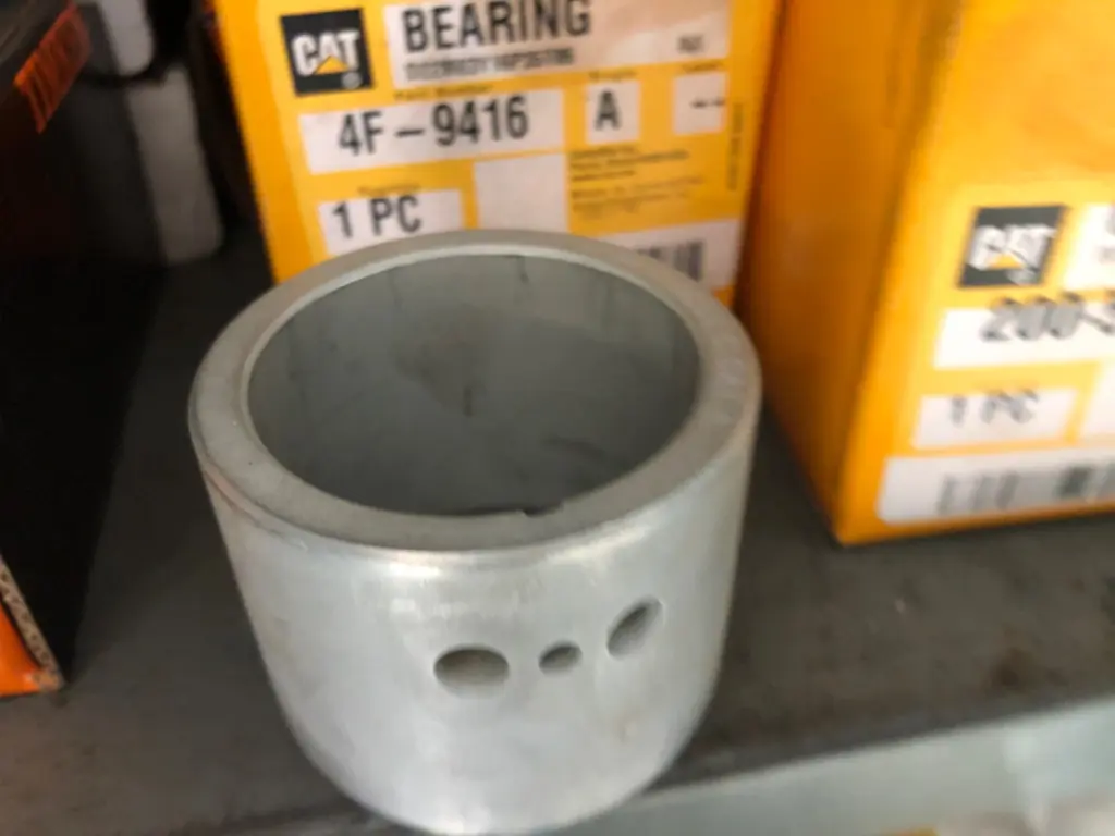

I am in need of a .030 undersize front main crankshaft bearing ( end with the timing gear)
Anything anyone is willing to part with out there, I'm open to other options if anyone has suggestions.

Do you have the part number handy? I have a new one from CAT, but I believe it is for the rear, which I assume not the same? Parts book not here, I can look next week. JM

Posts: 3,271
Thank you received: 71
Looks like mine is for the rear. Sorry. [attachment=61047]2D82D6EB-8635-4A7A-8AF7-F8B316CE5AF6.jpeg[/attachment]

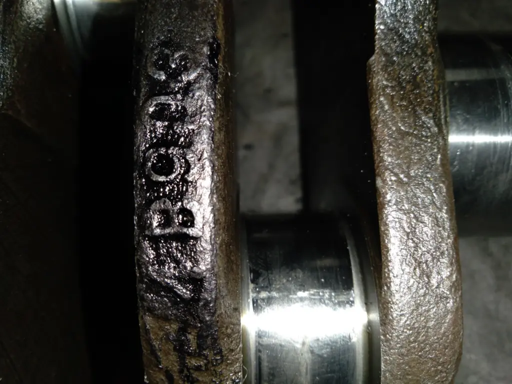

Would anyone have the standard crankshaft specs for the crankshaft in the photo? It's out a D4-6U [attachment=61088]20201115_144355.jpg[/attachment]
Mon, Nov 16, 2020 7:11 AM
Posts: 2,286
Thank you received: 31
Reply to Ttophoven:
well the bearing bores are listed as 1.8200 inches so the crank would be a slight clearance on that

Posts: 2,286
Reply to trainzkid88:
you may be able to speedi-sleave the crank back to a usable size it is also possible to get it built up and reground any good engine reco shop should be able to do that
