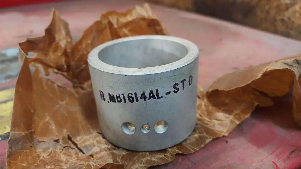

I have a standard main bearing that I would part with

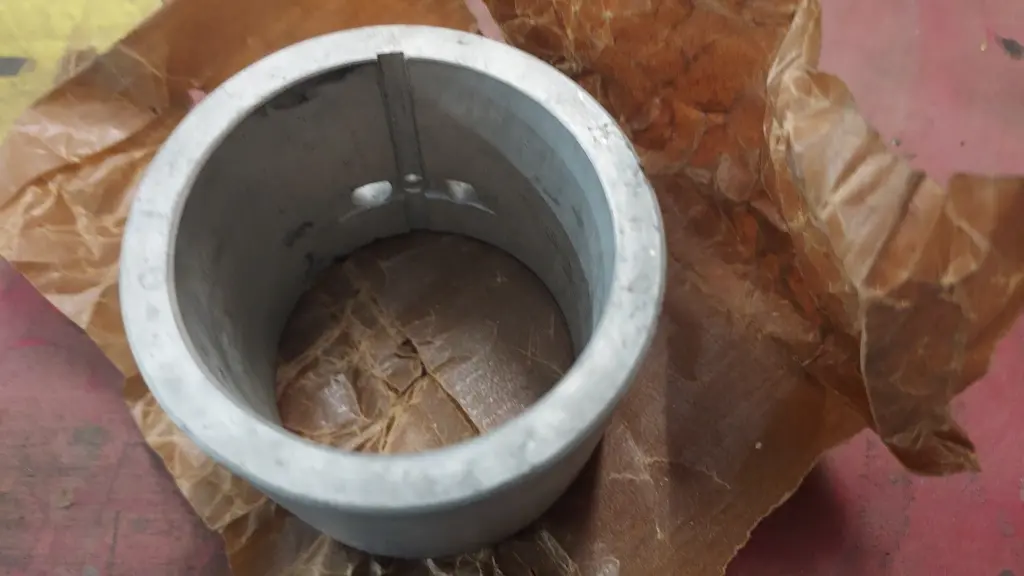

The price sounds fair. Mine has excessive scoring. Could you tell me more about the condition of your bearing. Is the bearing scored? Has it been previously used in an engine? Has the dowel hole been drilled?

Bearing is new unused condition.

You'll need to check your journal diameter. Gary's bearing is std so if your journal's been turned down, you'll want to build it back up to std. Easy for a machine shop to do and you'll end up with a perfect surface. Max axial play for good results is 015 - better if you can hit 010
