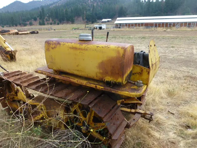

A question or note; Pre U series machines, the fender tank; did they all have a notch cut out of the bottom center or? I have seen D4 tanks that way, unsure about the J series 2. Just an observation. JM

Do you mean like this?

EXACTLY! You’re making me drool. Can I PM you talk about it?

I was mistaken (again) about the size of the D2 tank. The one on my 3J is 36 by 10.5 wide by 13 3/4 tall. I measured two different D4 G model side tank and they were within a 1/2 inch each way of my D2 tank. Maybe someone just used a D4 tank on mine, or the factory used what was easily available. Maybe 3J can measure his tank and see if it is different? Good Luck.

Mine is 36 long by 10 inches wide and 14 inches tall. My RD4 is about a half inch longer and about 1 1/2 wider than the 3J. The 3J looks pretty stock with the way the way the fuel supply ties into the supply line.
