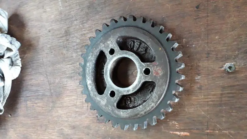

Hello folks looking for this gear part number 7B2074 it has 33teeth the starter motor engages to this on my 1945 D4 pony motor it is situated behind the belt pulley anybody got one to sell ? Thanks [attachment=59153]20200522_183835.jpg[/attachment][attachment=59152]20200522_183855.jpg[/attachment]

A good machine shop could weld those teeth back up and recut them. They have to have a short engagement bevel on them though.
