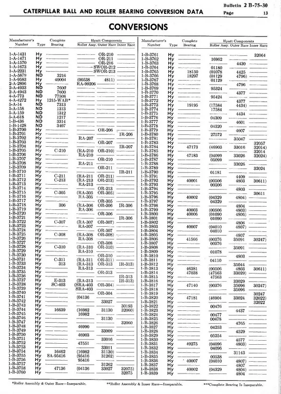

1B3738 converts to Hyatt :- complete Brg. SC-403, or, roller ass. SRA-403 and outer race OR-304. See scan below and save this to your files for future reference.
1B4099 converts to ND(New Departure) :- 20209.
Hope this helps.

I used two shorter pilot bearing inner races back-to-back in my 5U. Bearing guy said folks do it "all the time". Other option someone mentioned on here was plain bearings rather than roller.
