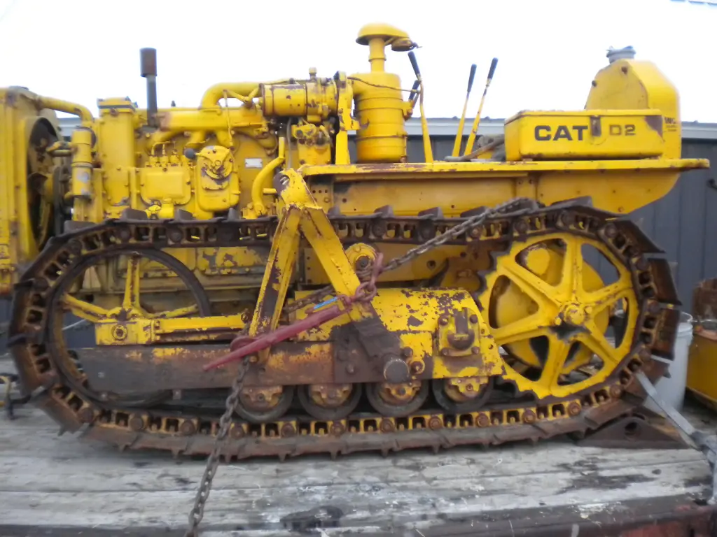

My 5U7474 has a stuck engine (4000 hrs). The machine sat for over twenty years.   I'm going south for the rest of winter and thinking of dumping 1/2 MMO  1/2 trans fluid down both stacks till I'm back late spring next year..  No antifreeze in the engine oil - engine can be turned slightly by hand with the belt.  Pony is free, no obvious issues.  Any reason NOT to do this?  Your advice is much appreciated.

Other than having to clean it out at some point, probably no objection. The mixture will likely not go into at least one of the cylinders if the valves are sealing ok. Is your goal to free up main engine pistons? You say that it turns slightly - could you estimate how many degrees the crank would turn? If it's more than say 10 degrees, then your main engine pistons might not be the issue. But again, it shouldn't harm anything per se

Thank you Neil. I am taking your advice. The engine can be turned by hand, with the belt maybe 10 degrees. It could be acorns or who knows stuck somewhere? Pulling the valve cover off ... everything under there is spotless. Can't wait till next spring. THX again.

I have encountered machines that had a stuck lifter is all. You could pour some of your magic mix into the valve train and hope that it soaks up the lifter bodies as well. I have had to replace the entire body before, as someone had become anxious and damaged them, not to mention bending the push rods. Good luck on your repairs. Hope to see a video of it running laps soon. JM

Also check the meshing of the ring gear to starter pinion tooth engagement (If the starter pinion is engaged or stuck from rust). We've run into some of these that were sitting and the clutch compartment got water in there and a tiny bit of rust gets into one or more teeth causing the flywheel to turn until it hits the junk in the teeth.
Yeah, when your into the valve cover; put some of your oil mixture on the valve stems and see if you can move any of them in. I've had luck on some engines to hit some with a soft hammer or even use some vice grips on ones that were stuck open and jiggle them some to free up. Just be careful not to chew up the stems.
Looking at your picture, I can see that the steering clutches are most likely stuck judging by the position of the levers.
You may want to consider putting some diesel fuel or kerosene in the steering clutch/brake compartments to soak . Make sure you have the drain plugs installed. That may help you since your going away and that may give you a jump next spring.

It will take some luck here as well. I have yellow fever but near zero D2 mechanic knowledge or skills. I am a good listener so thanks for the comments. I ordered a D2 track gauge from Chapter 19 The tale that tells is grousers are at the repair stage, sprocket as well. Surprisingly the track chain height shows 100%. Now,on to how to soak the turn clutches? Thanks again.
