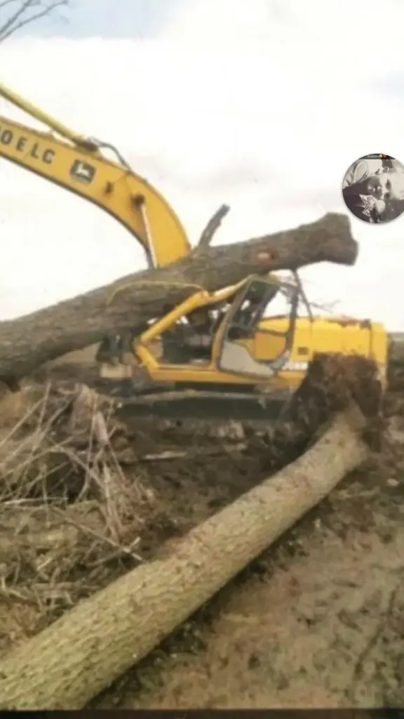

Competitor got the bid and could do the job cheaper, well....operator was pinned in the cab for 45 minutes till help arrived. Had broken bones and internal damage, almost killed! An excavator is NOT the right machine for tree clearing!!

Mmm..needed proper forestry guards.
Plenty of excavators used for clearing and forestry ops here in Aus nowadays. In fact with recent past massive fires here in Tasmania there were major issues in getting dozers to provide fire breaks. Some machines from the 1960s had to be pressed into service despite not complying with govt standards.
Excavators were also used in the process generally going ahead of the dozers to sweep brush and dead trees out of the way allowing the dozers to better disturb the soil etc and speed up the process.

Those little piss ass guards cannot with stand the weight of a large tree! But if your a "risk taker" then "Shake Hands With Danger", good luck. Besides, why sit there for an hour prying and prying and prying, stressing the boom, straining the hydraulics and end up with a big hole and dirt ball that you cant burn or have to haul away. Yep, some think they can do anything with an excavator.

My dad did clearing with his excavator many times while I was growing up. I have said many times that anyone.can run a machine, but it takes.someone special to operate it and get the maximum work out of the least amount.of fuel and time.

That to me shows inexperience I have been land clearing for 22 years been around the Logging businesses since I was 5 years old every piece of machinery has its own knack but if you have trees leaning over power lines or a building or a house an excavator is the way I roll no matter what size dig the stump just as you would saw it to fell where you want it to land we have no guards on any of our equipment not my choice but makes you be a little more careful never pull on cab side unless absolutely necessary and I have taken a lot of nasty trees down with a 963 n a fleco rake with grabs what a unique tool in the clearing business 👍 Jason
