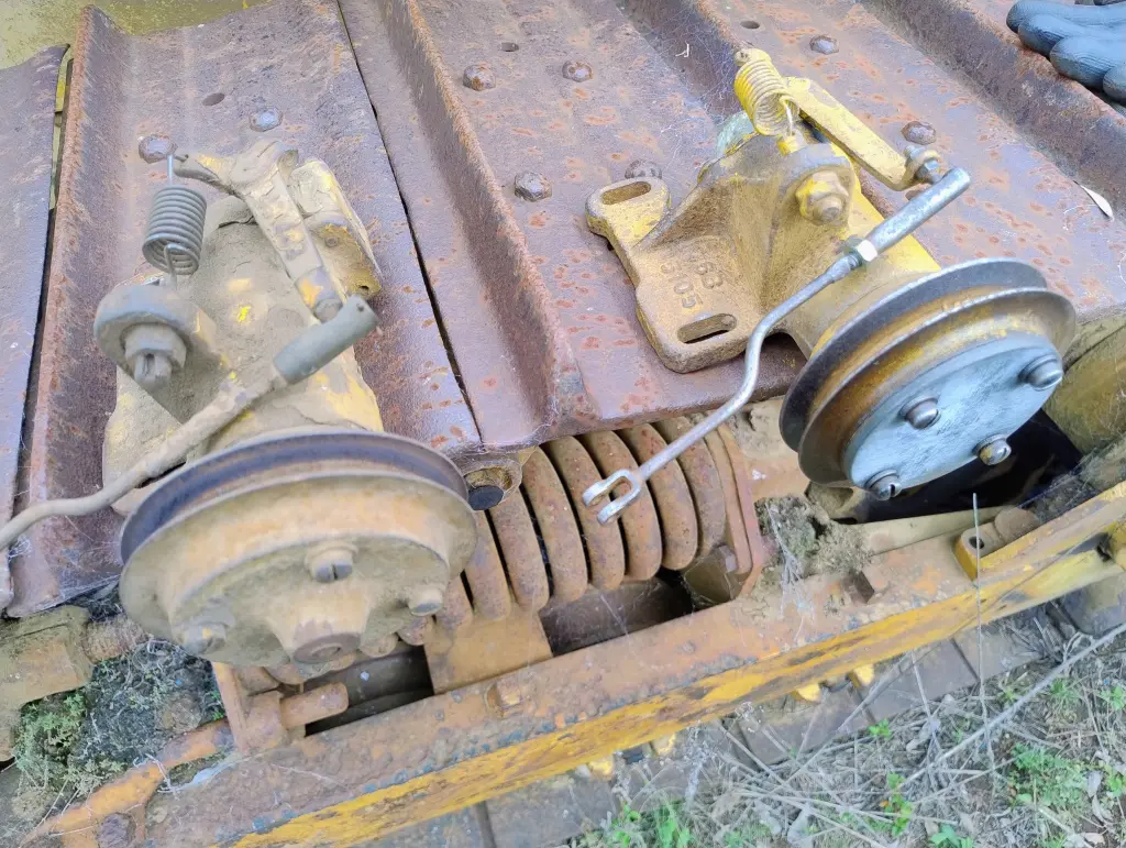

Pictures of the governor and dash from my late D4 6U. It has an early pony motor so I'm assuming governor should have a flat cap to suit a late dash.

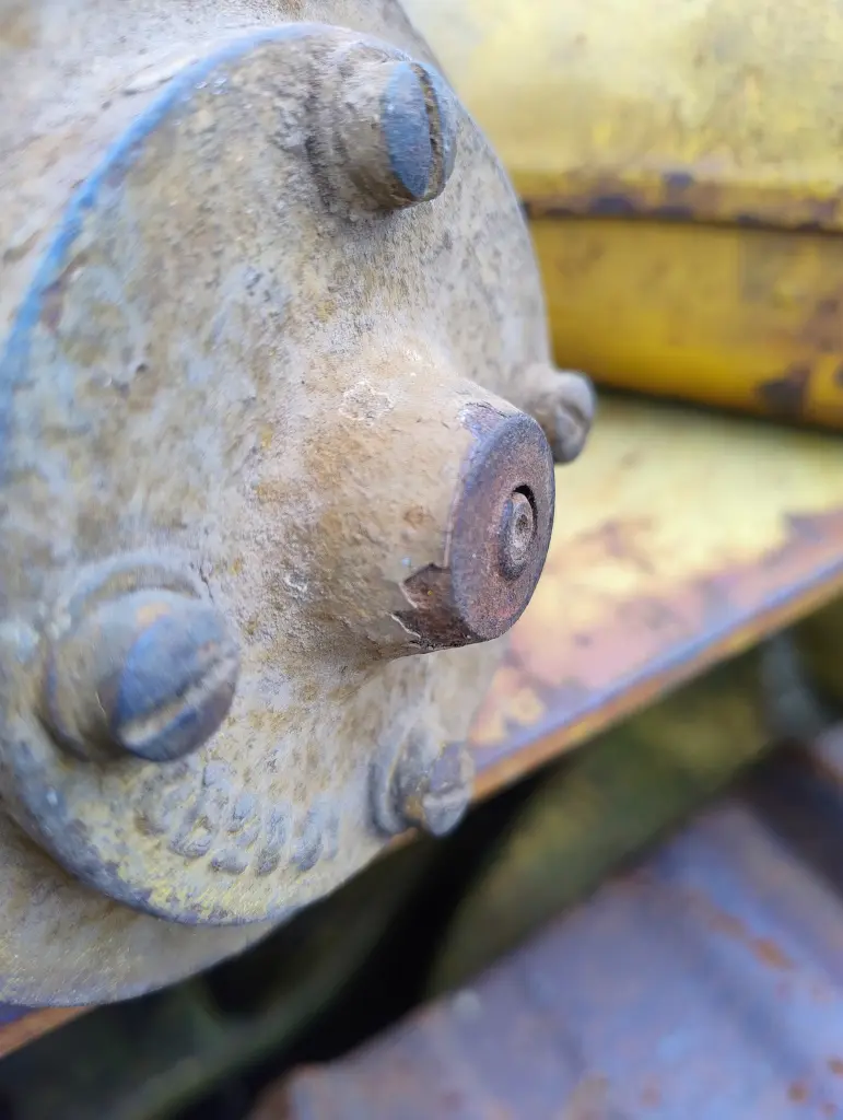

Witness mark in dash from governor nose. I don't know how long it was run like this.

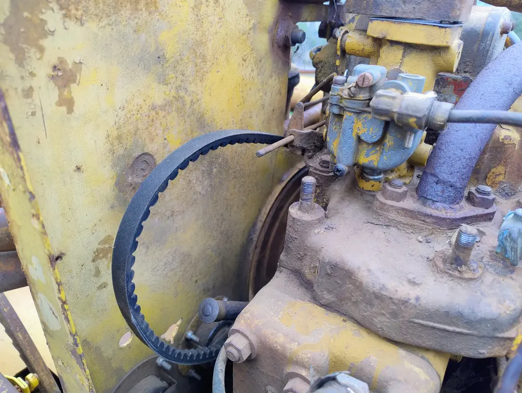

It seems every governor linkage I see has been welded up.

That is interesting. I have never given the governor/dash any thought. No "dimple" on your dash. I suppose one could make one or bore a hole out for clearance. You already have the smooth faced one, solution in hand. Never seen any gov linkages welded here.

Haus,
you indeed have the earlier style governor and its style of cap which supported the end of the sliding control shaft--the shaft is supposed to slide in said cap, which is now missing its outer material, which has exposed the shaft so I guess the shaft is now seized and the Gov. would be inoperative.
From ,memory the later Gov. should work okay on the older pony manifold.
