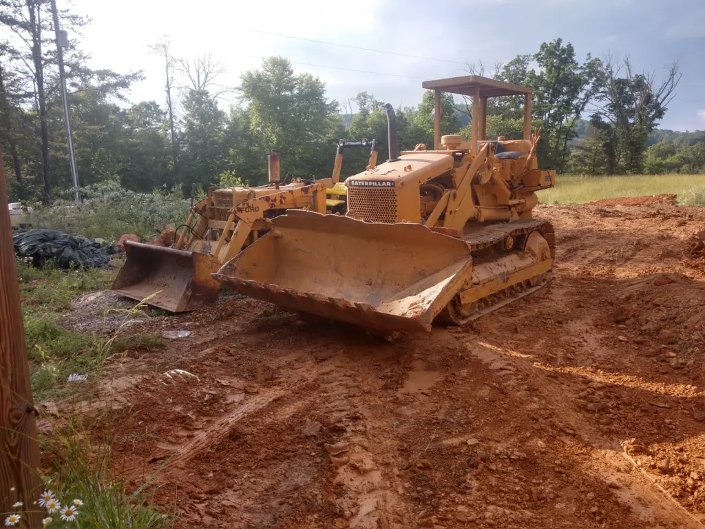

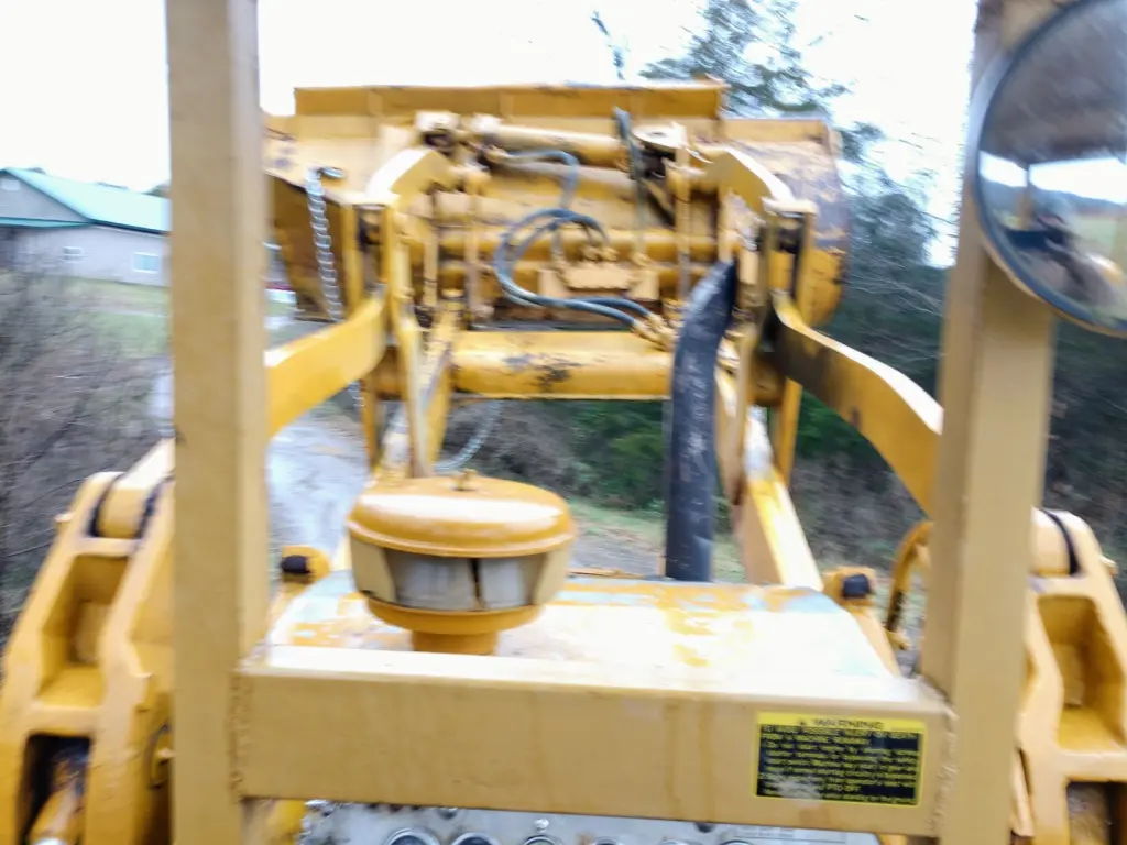

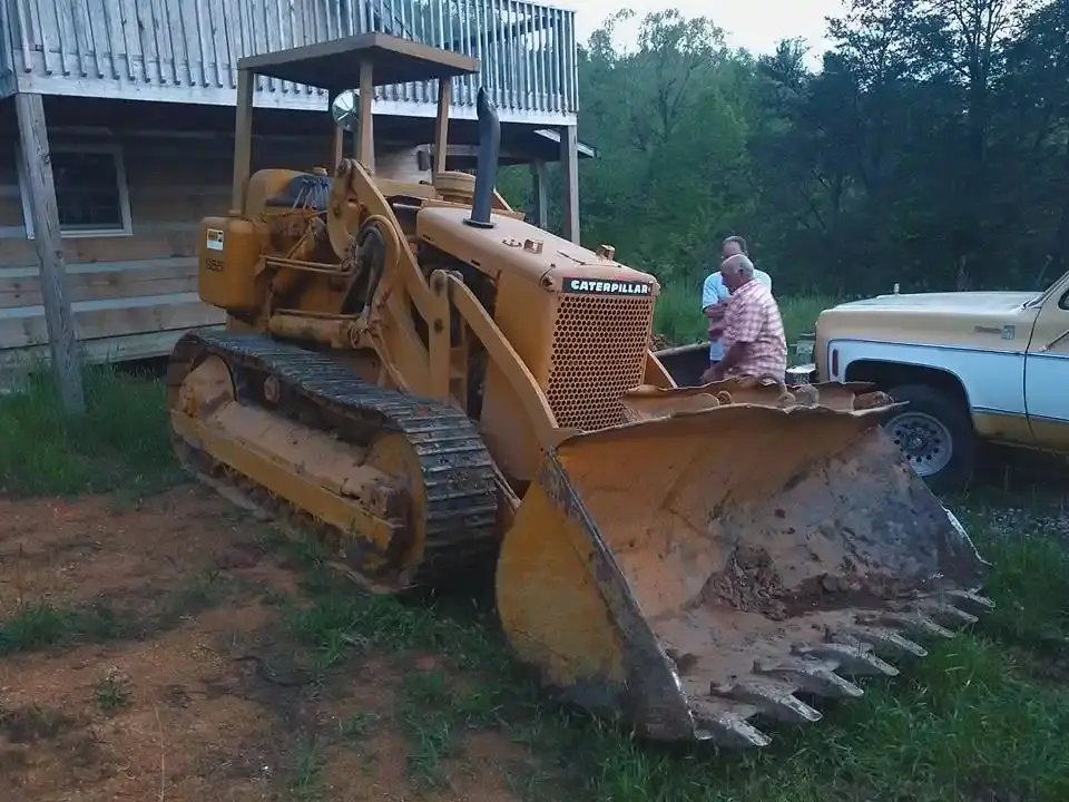

@Brandt - My 955H has a factory D4E winch on it, I've attached some pictures for you. Mine is a powershift machine, I haven't used the winch much but from memory...I have to put the range selector in neutral for using the winch because it is driven off a shaft from the transmission PTO.   [attachment=72278]Cat 955H.jpg[/attachment] [attachment=72279]Cat 955H - winch.jpg[/attachment] [attachment=72280]Cat 955H.jpg[/attachment]

Interesting bucket you have there - what's the story on that angled plate inside it?

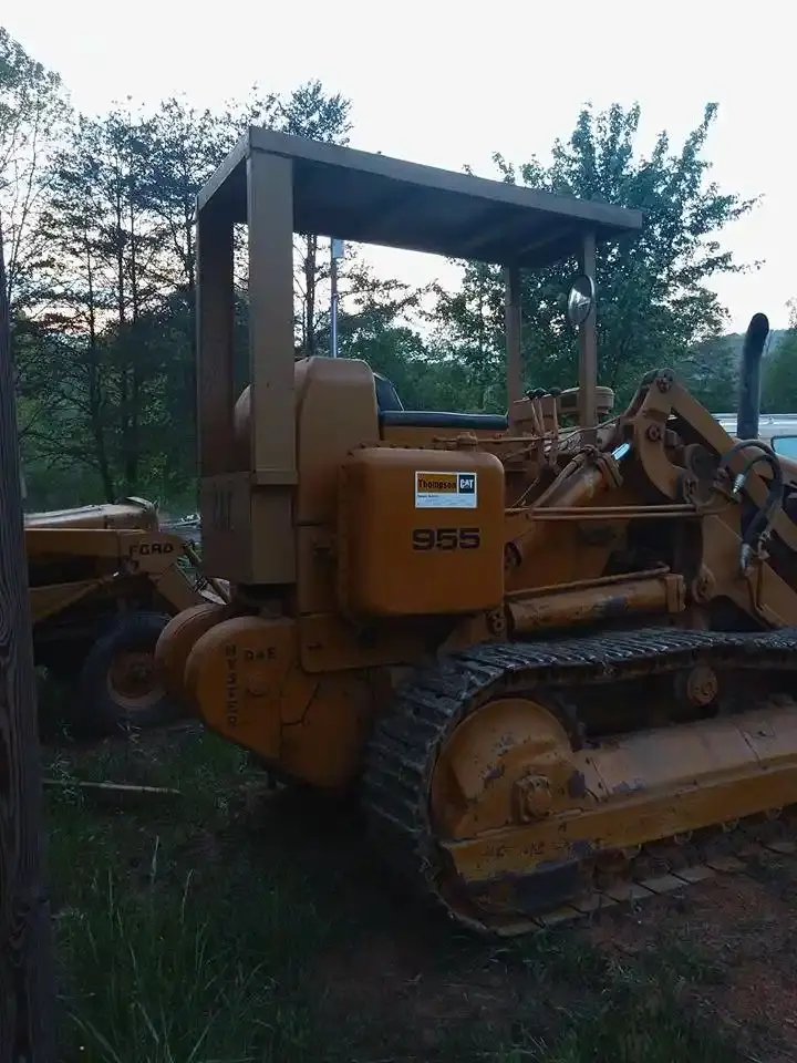

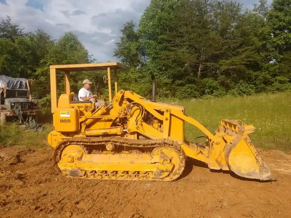

 [attachment=72282]IMG_20180525_183934233_HDR.jpg[/attachment] [attachment=72281]IMG_20181220_104308494.jpg[/attachment]@neil - it's a side dump bucket, I've heard some possible reasons for it being on the machine. May have been a railroad machine or some other type of loading machine. It's a fairly low hour machine with a really good undercarriage and clean running D330. All the options are what got me interested in it.

Nice machine! Your hood slopes more than mine, and you don't have the homemade ROPS

I have a sidedump bucket. They work great for pushing dirt back into a trench with the dirt along the trench. They also work great for moving deep heavy snow. I believe I read somewhere the reasoning for the sidedump was to save on the undercarriage by less turning. Running only forward and reverse to load out trucks.
