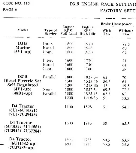

Hi Team,
be aware that by the Rack Charts the early U tractors were rated at 1400 Rpm Full Load Speed and later ones were 1600 Rpm F.L.Speed
Correspondingly the Horse Power went from 51 to 58 and then 60.5 by the end of my Chart range.
This then took advertised travel speeds (that I found in Sales [1947] and Parts literature[3-1952]) in MPH from / to,
1st 1.7 to 1.9
2nd 2.4 to 2.7
3rd 3.0 to 3.4
4th 3.7 to 4.2
5th 5.4 to 6.1
Rev 1.9 to 2.2

Hi Team,
1st 1.7 to 1.9
2nd 2.4 to 2.7
3rd 3.0 to 3.4
4th 3.7 to 4.2
5th 5.4 to 6.1
Rev 1.9 to 2.2
