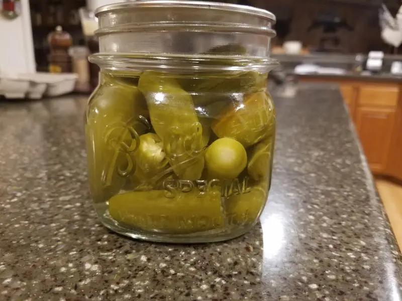

My wife actually collects canning jars and the ball specialwide mouth actually aren't that special. Collectors value is under $10 As a matter of fact she just canned 2 cases of jalapeno candied peppers
[attachment=50997]20181008_200510.jpg[/attachment]

Hah! I'll take six jars with the jalapenos!
