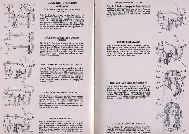

Maybe these pictures will help

As for the pictures, they are the same ones I copied from a 5U service book. I thought there'd be some help in there, but it is too general in nature. thanks all the same.
