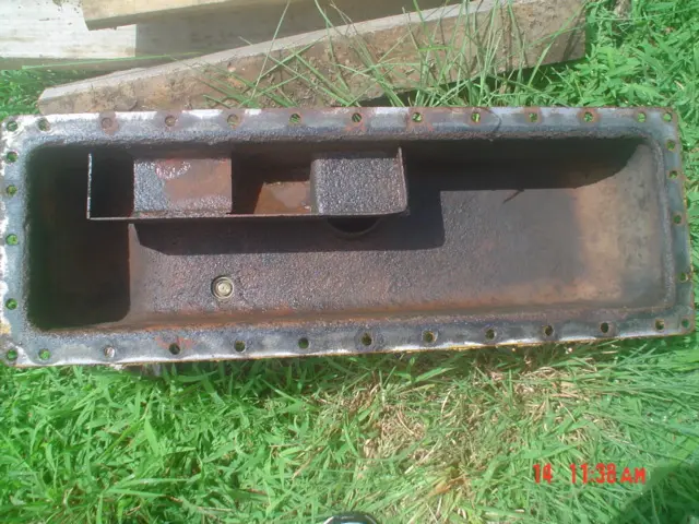

i got the trans temp on the dozer and used the dozer for about an hour the other day clearing a road to a spring and dammed it up a bit to hold the cows some water and the engine temp got up to about half way to the red mark and the trans temp only moved up a 1/4 or less, so hopping the trans is not overheating. while i got it here at the house still id like to try and flush the radiator out and see if that will help any before taking it back to start cleaning up ground again. i have heard to use vinegar,muriatic acid, or lye is about the best to use, what do yall recommend and how would be the best way to do it? im thinking would want to remove the hoses and plug them before filling the radiator to keep all the crud from going into the engine correct? here is the picture of the top of the radiator hope the inside isnt that bad but never know.

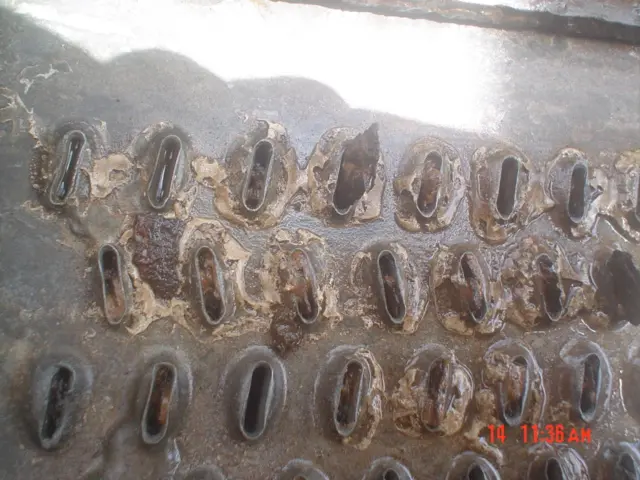

took the top tank off today and about half of the tubes are stopped up, any ideas what i could use to rod it out with?
I used the fuel tank dipstick on my D2 - width and thickness fit perfectly although it was a couple of inches short

To rod out a Thirty radiator I used ~3' of "Signoid" type steel pallet strapping. It was ~1/2" wide X 1/32" thick. Don't remember if I folded over the lower end though (it was in the early 1960's).

If you can find one. An old band saw blade is the best. Grind the teeth off until it fits easily down the tubes .
If they are badly blocked use a piece of brass welding wire first to break through.
As stated earlier a length of pallet strapping ground to the suitable width works also.

ok, just roded all out but 3. started with the dipstick out of my truck and finished with the dozer dipstick. probly around 25 tubes that was stopped up on down inside and around half of them with crud plugging them up on the very top. on the 3 that i do like how hard can i poke them, im afraid to give them to much of a blow. the tank doesnt look bad other than the filler neck, and when i rebuilt the engine the water jackets that i could see didnt look to bad either.

Plumb a garden hose into the drain in the lower radiator pipe and turn it on just enough to push all the debris up out of the flues as you rod them out. Helps to determine which are plugged and when you have gotten them open etc. Doesn't need to spray up like a fountain, just well up and pour off the top plate.
I used the stainless steel strips from a minivan wiper blade to rod the last one I did. It was still a little short on the D6 so I silver soldered another foot onto it. Whatever you use, bend a little L on top so it doesn't drop in and you loose it!
I got only maybe 90% of the tubes open even using the thin stainless strips, but the tractor stayed cool just fine after that.

Looks good! I say don't go for broke on the last few flues. Just not worth having to fix a leak.
I found the same as you on both of the ones I did. A double handful of rust flakes laying on the top of the core.
