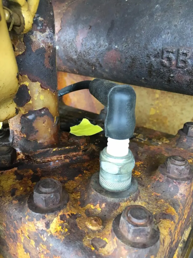

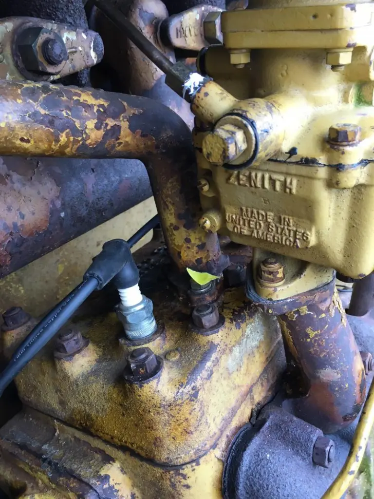

i just tried to start my 1h D8 after it had been sitting for a few years. started the pony right up but after turning the main for a few minutes I could get only get the run position to work in low speed which wasn't enough to start the main engine. as soon as I try to put the pony in high gear and throw the compression to run, the pony dies. on top of that coolant started to blow out from around where the manifold that goes into the pony head, because the 2 bolts holding it in place had vibrated loose. I shut it down and tightened those bolts back up, but the next day when I went to give it another try I checked the oil in the pony and it was full of coolant. I have drained the oil and replaced it with fresh, but I am now trying to decide if the coolant got into the oil somehow when the bolts were loose, or does it sound like it could be a bigger problem? I am going to check the compression in the cylinders but does anyone know what the compression should be? I have a shop manual for the main and the pony but it doesn't list the compression. Thanks in advance for any ideas or suggestions!

Can you post a photo of the bolts you tightened so we can identify when the leak was.

here are pics of the left and right side of the coolant manifold bolts that came loose.

Seems to me about the only way you could get coolant in the oil is through a bad head gasket or cracked head or block. I don't think the line flange bolting has anything to do with it. Do you live in cold winter country?
