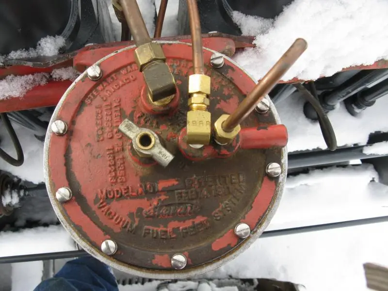

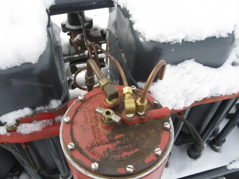

Thanks Chad for the info could you send me some pictures of how your vac tanks hooked up I'm not sure that this one is quite right hasn't never run really right was thinking of just bypassing it to see if it would run differently. Have a merry Christmas and a happy new year hope to hear from you soon. Jason
Wed, Dec 26, 2012 8:20 AM
WyoCat
Posts: 730
Reply to Jason 10/D4:
Jason 10/D4,
Sorry for the slow response. Here are some pictures of the fuel line arrangment. I'll try to explain what they are, etc.
The top one. That port on the Vac tank is labeled "fuel line". That would be the fuel line from the tank.
The one in the middle slightly to the right is labeled "vacuum line". That line goes to the intake manifold.
The far right port is the vent port and I cannot remeber if it is labeled on the tank or not.
The far left port is just a fill port. This port is used to do an initial fill of the vac tank if it is empty for some reason. This just needs to be plugged. This tank has a pet cock in that port which was handy for troubleshooting.
Please let me know if you need anything else or if I can help in any way!
Take care and I hope this finds everyone well!
[attachment=15805]vac tank arrangment 001.jpg[/attachment][attachment=15806]vac tank arrangment 002.jpg[/attachment]
