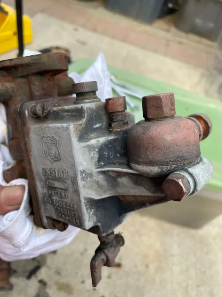

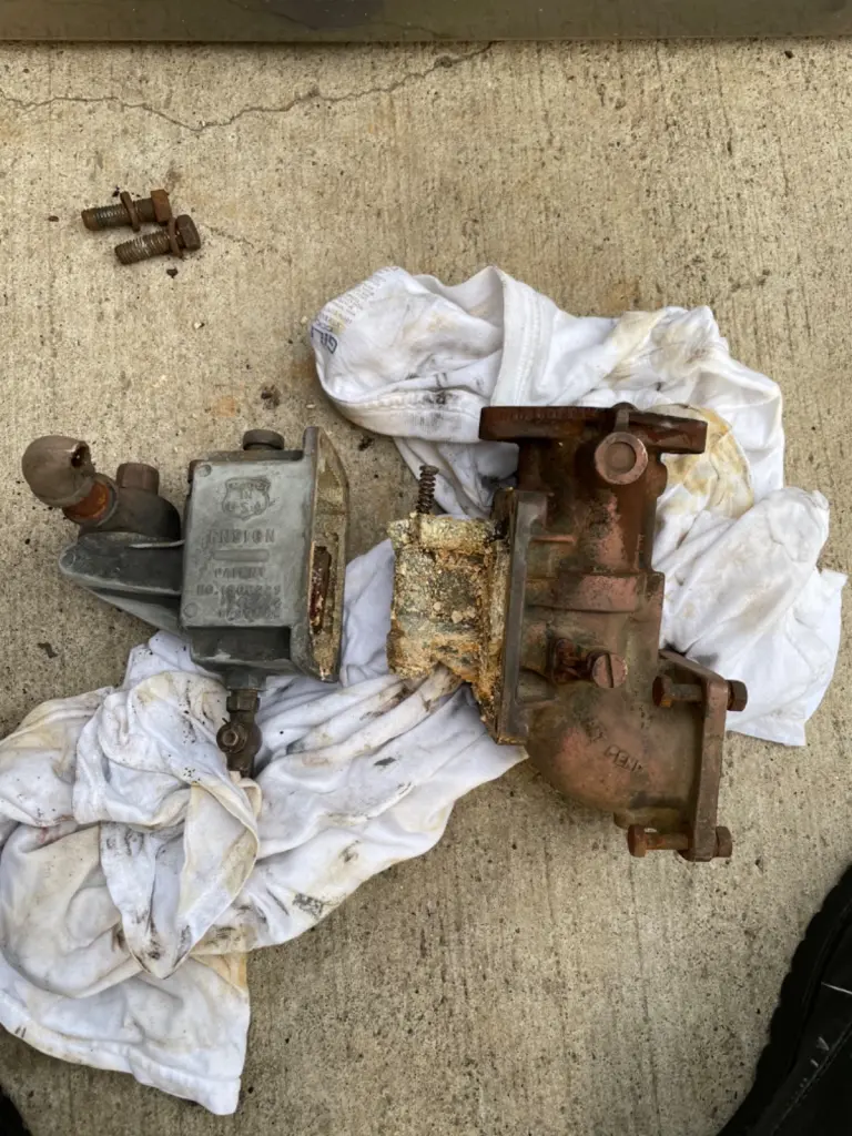

Can someone name the model of ensign carburetor this is?and where to find rebuilt parts or kits or where can I have someone do it for a fair price and is it a original for a caterpillar twenty?Any information much appreciated thank you.

i would take it to a local small engine shop and have it sonic bathed after giving it a good soak in hot soapy water to rinse off some of that crud. the model should be cast stamped on the side. a little CLR or the like will help disolve the encrustation short soakings only. white vinegar also works and is cheap. use a old tooth brush to scrub it. note it must be rinsed well and oiled with rp7,wd40 etc to prevent flash corrosion.
do you have a parts book for your machine. if so try the dealer or florin tractor they should be able to supply parts. if your a acmoc member you would have access to the member library. there is a copy of the parts book in the library.
i just found it yes its not real clear to read but it does have the part numbers. and a google search with those numbers might just get you the ensign company numbers and then you might be lucky at a auto parts joint.
it has the ensign numbers listed so you might be in luck.

Spent a half hour looking for a chart of ensign carbs and the CAT tractors that they fit but I cant find it anywhere. Chad Enyart should be able to help you. He's an ACMOC member

Look like either an AEL or an AES. If I had to guess I would say AEL which is for the early Twenties. On the flange that has the two bolts there should be some numbers stamped into one side of it. Some of the AEL's also have a L stamped on top of that flange. I would send it to Chad.

Who is chad and how can I get ahold of him?

Look up a couple posts. Chad Enyart, ACMOC member

Chad's username is wyocat

Looks like a Cat Thirty carb.

unless you are totally into the original/restore thing, another small carb will work flawlessly....even if it is remotely close to spec..
-carbs are unbelievably forgiving and compensate even if 100 percent not correct for application..just another option etc..

Hi All,
Have a look in the Technical library for this doc it has all the carby there.
Caterpillar Accessory and Supply Catalog Form 1736 May 1944
