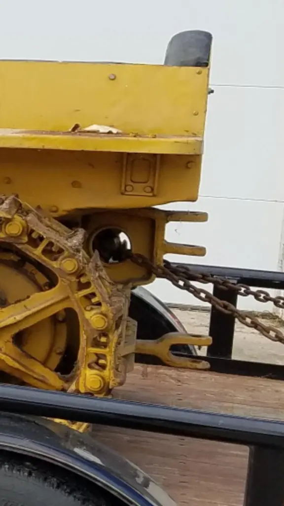

Hi I am wondering if anyone has a picture of what a high hitch is supposed to look like. The one I have has had a hitch welded to it. But looks like something was cut off where the hitch is now welded on.

Hi, 55BelairDan.
Here 'tizz.
[attachment=52656]Cat 22 wide with high hitch drawbar on New York Island_1A_Acmoc.jpg[/attachment]
Sorry 'bout all the rust spots. Dat Noo Yoik Island must be a terrible dump for old machinery. LOL.
Whooo pootchyer tracks on bass ackwards??????????????????????
A kew-ree-yuss mind would like to know.

Thanks for the picture! When someone in my family in the late 60s had the pins and bushings replaced they put them on backwards. I have now switched one side around when I took the track frame off and replaced it with a nice not bent and rusty one. Also made new bushings for the rollers. I'm going to start on the other track tomorrow.
Hi, 55BelairDan.
Yer welkum, Sir. Hope it helps. Happy track switching.
