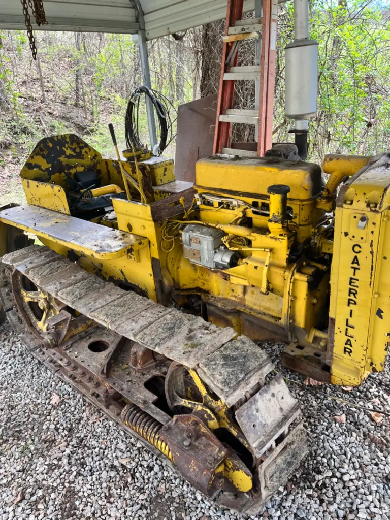

Hello all. Been a member since early 2024. 1st time posting. I’ve got a 2F Twenty two giving me fits. Bought it early this year. Started just fine (even in the cold) 2-4 pulls and she was running. Started it up a few times between spring and summer. Anyway…this summer I started tearing it down (sheet metal) to start restoring. After it sat in the shed a few weeks I went to start it and she wouldn’t hit a lick. Checked the usual….spark, fuel etc. but nothing. Messed with it off and on for a couple months with no success. So tonight I went out. Put some fuel in the priming cups, gave it half choke and she fired right up lol   Let it run for 10 minutes or so, waited another 15 minutes and she fired up again. I bought some Autolite plugs for it so after the second start-up I put the new plugs in (old ones were pretty rough looking). Went to start it up and wouldn’t you know it….nothing. It tried to start 1 time but that’s it. Figured maybe I flooded it…let it sit for a few hours and still, won’t hit a lick. I will add I’m not running a fuel pump…just gravity feed. But it’s getting fuel.
