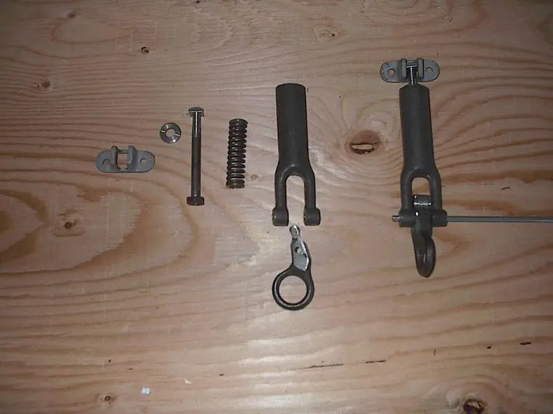

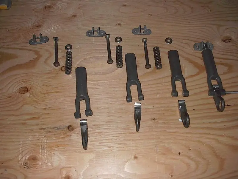

I needed the early style hood latches for TWENTY (L/PL), part number L1327. Jim Zimmerman offers the later style, part number T537. I purchased the T537's from Jim and made modifications: machined new plunger rods from square headed bolts and reworked the finger pull to be compatible with "hook" used with L1327. See photos.

Good solution there, but don't stop at just 4 now you have it worked out, I bet you would be on everyone's Christmas card list if you knocked up a 100 or more for your Cathead buddies!😆

Nice job Kent. I will have to get a couple from Jim when I do our club's 20.
