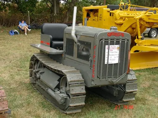

MARCOTEN
Posts: 530
Reply to wimmera farmer:
Ha Ha! practice what you preach Mr President ( i know you already do and you are not to be encouraged) not my style thanks.
It will be battleship grey (not sure which battleship) with black trim me thinks.
both pics show the most Original colors for before 1932. battleship ( dark) gray with red trimming.
silver heat resistant paint on exhaust /intake manifold
[attachment=55562]Mark Olsen's Fifteen.jpg[/attachment]
[attachment=55563]z f (1).jpg[/attachment]
