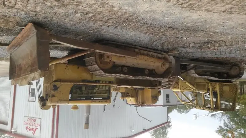

[attachment=45026]D8.jpg[/attachment]
Right side up.

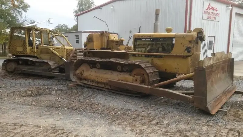

Hi, JAMESCOWGER.
Nice looking machine but I thought you said you had acquired it locally. Your photo looks more like it is nearer to me here in DowNunda.
Does this look better? I 'bigged' it a little too, using a program called GIMP 2.8, which is a freebie: https://www.gimp.org/downloads/ If you want to download it, I would advise AGAINST using the bittorrent download.
[attachment=45027]Cat D8 15A645 cable dozer_1L_Acmoc.jpg[/attachment]
Gotta admit though, it did appear to have pretty good 'traction' in your photo to be able to hang on on that 'slope'.

I saved the pic to my computer then used Microsoft Paint to rotate it and save it sitting on the tracks, and then re-posted it LOL. Not a lot of difference from these peepers.[attachment=45038]D8.jpg[/attachment]

JAMES COWGER

Reply to d9gdon:
thanks, don't know why it posted upside down

JAMES COWGER
Send a private message to JAMES COWGER
Posts: 8
Hi, JAMESCOWGER.
gotta admit traction is good but not that good, have already done a lot of work to it, fuel system, tank & converter were totally dry when I found it, freeze plugs in pony motor rusted through,
pulled pony motor, replaced freeze plugs , rebuilt mag & carb, pony motor ran, but diesel motor wouldn't start even with fuel pressure, used pony motor to raise blade, pushed it onto trailer & brought it home to shop, discovered fuel valves rusted up & totally destroyed, replaced fuel valves & engine ran, oil pressure was good, had noise in lower end, pulled oil pan & found rear sump torn up, found out previous owner put new radiator & rebuilt tracks prior to his passing 28 years ago, he also apparently rolled new mains & rod bearings in it, when the oil pan was reinstalled they missed lining up the gasket between both 1/2 of the oil pan, they also forgot to put spring, shims, nut & key in rear oil pan that holds rear sump. replaced rear sump, noise went away. still work in progress on rest of machine.
other 'toys' TD7 IH, TD15C, along with my baby the D815A, regards
