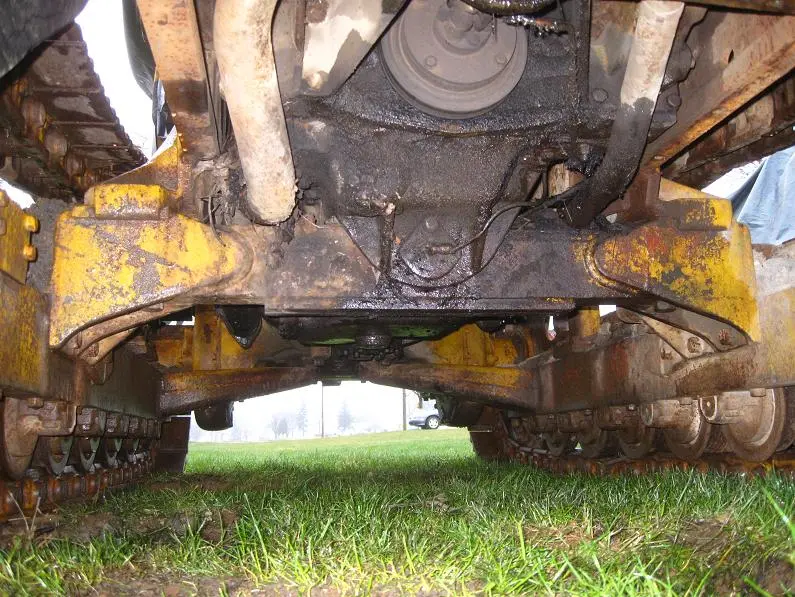

My soon to be work area... Note the cross member that I have to lift the engine up over to get the oil pan off.
Tue, Mar 23, 2010 9:56 AM
Posts: 16,788
Thank you received: 50
Reply to Bill Glenn:
Your picture doesn't do justice to the overall shape of the cross member.
I have seen grown men cry trying to wrestle the oil pans off of Ht4's and 955's.
Some even concluded it couldn't be done without gas axe assistance. Pretty easy to see that the loader was built around the tractor when you try to take it apart.
Doesn't help that there is no service manual specifically describing the loader.
Most the bearing failures I've seen were a combination of smear and flaking. Pounding out chunks or flakes seems more common to babbitt type bearings but there is no specific set of events.

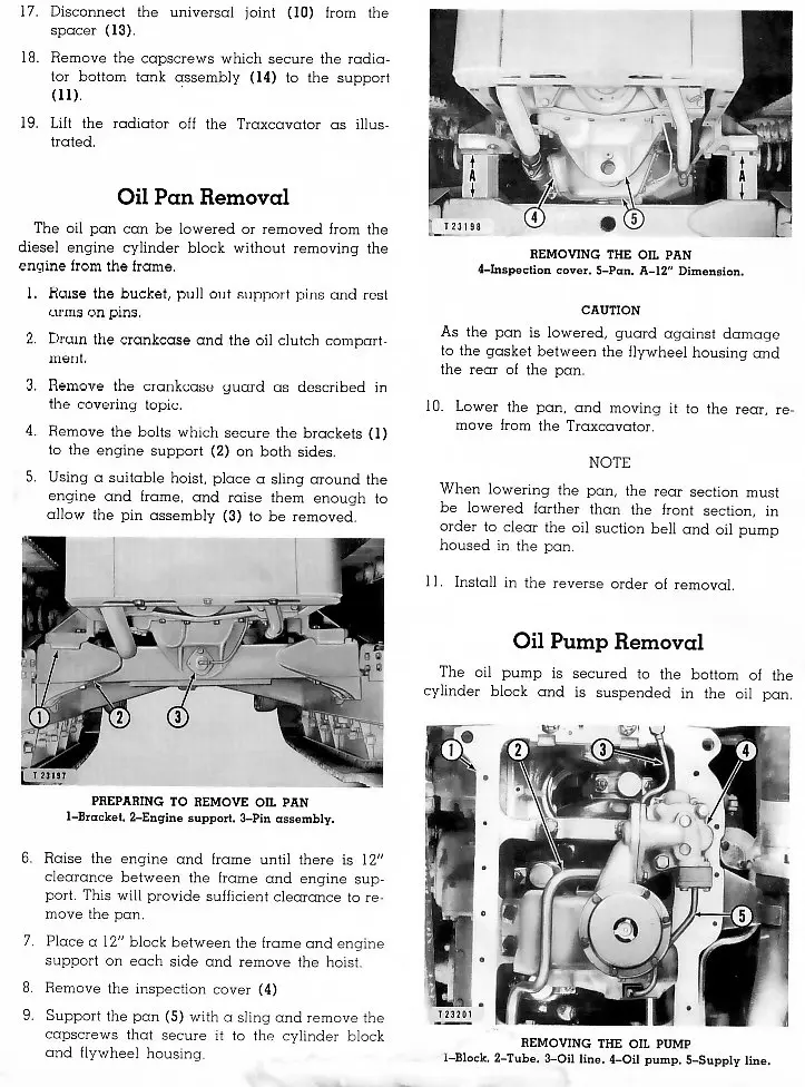

Hi Team,
have at last now found my Service Information Form as above for the 955 Traxcavator.
It details "how to" for this machine and I guess was the forerunner for the Official Service Manual for this unit. It is used in conjunction with the Engine and Tractor SRM's --4 1/2" bore 4 cylinder and D4.
Scanned below is the section for pan removal.
Hope this helps.
Tue, Mar 23, 2010 12:25 PM

Nothing like having the instructions😊 😊
Thanks edb.
That is a rare piece of literature designated as Service Information.
I have never seen a Service Manual designated for the 12A.
I do see several pieces of literature designated as "PS" that apply to the 12A but I do not know what that designation means....maybe "parts service"??
The first loader service manual I've seen is for the 60A.
Anyone know or have any different info??
